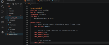

Biblioteke mam w folderze lib jak na zdj i plik ini tak wyglada. Log ponizej Kod ktory próbuje skompilować #include <Arduino.h> #include <rtl_433_ESP.h> rtl_433_ESP rf; // Bufor na odebrane wiadomości (wymagany przez setCallback) char msgBuffer[512]; // Funkcja zwrotna (musi przyjmować char*) void log_receiver(char* message) { Serial.print("Odebrano: "); Serial.println(message); } void setup() { Serial.begin(115200); delay(1000); rf.setCallback(log_receiver, msgBuffer, 512); // ZMIANA: Usuwamy "2", zostawiamy puste nawiasy rf.enableReceiver(); Serial.println("Odbiornik rtl_433 aktywny..."); } void loop() { rf.loop(); } Compiling .pio\build\esp32dev\lib17f\rtl_433_ESP-main\rtl_433\devices\vaillant_vrt340f.c.o Compiling .pio\build\esp32dev\lib17f\rtl_433_ESP-main\rtl_433\devices\vauno_en8822c.c.o Compiling .pio\build\esp32dev\lib17f\rtl_433_ESP-main\rtl_433\devices\vevor_7in1.c.o Compiling .pio\build\esp32dev\lib17f\rtl_433_ESP-main\rtl_433\devices\visonic_powercode.c.o Compiling .pio\build\esp32dev\lib17f\rtl_433_ESP-main\rtl_433\devices\watts_thermostat.c.o Compiling .pio\build\esp32dev\lib17f\rtl_433_ESP-main\rtl_433\devices\waveman.c.o Compiling .pio\build\esp32dev\lib17f\rtl_433_ESP-main\rtl_433\devices\wec2103.c.o Compiling .pio\build\esp32dev\lib17f\rtl_433_ESP-main\rtl_433\devices\wg_pb12v1.c.o Compiling .pio\build\esp32dev\lib17f\rtl_433_ESP-main\rtl_433\devices\ws2032.c.o Compiling .pio\build\esp32dev\lib17f\rtl_433_ESP-main\rtl_433\devices\wssensor.c.o Compiling .pio\build\esp32dev\lib17f\rtl_433_ESP-main\rtl_433\devices\wt0124.c.o Compiling .pio\build\esp32dev\lib17f\rtl_433_ESP-main\rtl_433\devices\wt450.c.o Compiling .pio\build\esp32dev\lib17f\rtl_433_ESP-main\rtl_433\devices\x10_rf.c.o Compiling .pio\build\esp32dev\lib17f\rtl_433_ESP-main\rtl_433\devices\x10_sec.c.o Compiling .pio\build\esp32dev\lib17f\rtl_433_ESP-main\rtl_433\devices\yale_hsa.c.o Compiling .pio\build\esp32dev\lib17f\rtl_433_ESP-main\rtl_433\list.c.o Compiling .pio\build\esp32dev\lib17f\rtl_433_ESP-main\rtl_433\logger.c.o Compiling .pio\build\esp32dev\lib17f\rtl_433_ESP-main\rtl_433\output_log.c.o Compiling .pio\build\esp32dev\lib17f\rtl_433_ESP-main\rtl_433\pulse_analyzer.c.o Compiling .pio\build\esp32dev\lib17f\rtl_433_ESP-main\rtl_433\pulse_data.c.o Compiling .pio\build\esp32dev\lib17f\rtl_433_ESP-main\rtl_433\pulse_slicer.c.o Compiling .pio\build\esp32dev\lib17f\rtl_433_ESP-main\rtl_433\r_api.c.o Compiling .pio\build\esp32dev\lib17f\rtl_433_ESP-main\rtl_433\r_util.c.o lib/rtl_433_ESP-main/src/rtl_433/pulse_data.c: In function 'pulse_data_print_vcd_header': lib/rtl_433_ESP-main/src/rtl_433/pulse_data.c:80:19: warning: assignment discards 'const' qualifier from pointer target type [-Wdiscarded-qualifiers] timescale = "1 us"; ^ lib/rtl_433_ESP-main/src/rtl_433/pulse_data.c:82:19: warning: assignment discards 'const' qualifier from pointer target type [-Wdiscarded-qualifiers] timescale = "100 ns"; ^ Compiling .pio\build\esp32dev\lib17f\rtl_433_ESP-main\rtl_433_ESP.cpp.o Compiling .pio\build\esp32dev\lib17f\rtl_433_ESP-main\signalDecoder.cpp.o Compiling .pio\build\esp32dev\lib17f\rtl_433_ESP-main\tools\aprintf.cpp.o Compiling .pio\build\esp32dev\FrameworkArduino\Esp.cpp.o Compiling .pio\build\esp32dev\FrameworkArduino\FirmwareMSC.cpp.o Compiling .pio\build\esp32dev\FrameworkArduino\FunctionalInterrupt.cpp.o Compiling .pio\build\esp32dev\FrameworkArduino\HWCDC.cpp.o Compiling .pio\build\esp32dev\FrameworkArduino\HardwareSerial.cpp.o Compiling .pio\build\esp32dev\FrameworkArduino\IPAddress.cpp.o Compiling .pio\build\esp32dev\FrameworkArduino\IPv6Address.cpp.o Compiling .pio\build\esp32dev\FrameworkArduino\MD5Builder.cpp.o Compiling .pio\build\esp32dev\FrameworkArduino\Print.cpp.o Compiling .pio\build\esp32dev\FrameworkArduino\Stream.cpp.o Compiling .pio\build\esp32dev\FrameworkArduino\StreamString.cpp.o lib/rtl_433_ESP-main/src/rtl_433_ESP.cpp:58:16: error: 'radio' was not declared in this scope Module* _mod = radio.getMod(); ^~~~~ lib/rtl_433_ESP-main/src/rtl_433_ESP.cpp:58:16: note: suggested alternative: 'rmdir' Module* _mod = radio.getMod(); ^~~~~ rmdir lib/rtl_433_ESP-main/src/rtl_433_ESP.cpp: In static member function 'static void rtl_433_ESP::initReceiver(byte, float)': lib/rtl_433_ESP-main/src/rtl_433_ESP.cpp:176:15: error: 'radio' was not declared in this scope int state = radio.beginFSK(); ^~~~~ lib/rtl_433_ESP-main/src/rtl_433_ESP.cpp:176:15: note: suggested alternative: 'rmdir' int state = radio.beginFSK(); ^~~~~ rmdir In file included from lib/rtl_433_ESP-main/src/rtl_433_ESP.h:33, from lib/rtl_433_ESP-main/src/rtl_433_ESP.cpp:25: lib/rtl_433_ESP-main/src/rtl_433_ESP.h:217:30: error: 'STR_MODULE' was not declared in this scope logprintfLn(LOG_ERR, STR_MODULE " " FUNCTION " failed, code: %d", \ ^~~~~~~~~~ lib/rtl_433_ESP-main/include/log.h:52:12: note: in definition of macro 'logprintfLn' printf(args); \ ^~~~ lib/rtl_433_ESP-main/src/rtl_433_ESP.cpp:178:3: note: in expansion of macro 'RADIOLIB_STATE' RADIOLIB_STATE(state, "radio.begin()"); ^~~~~~~~~~~~~~ lib/rtl_433_ESP-main/src/rtl_433_ESP.h:217:30: note: suggested alternative: 'SPI_MODE0' logprintfLn(LOG_ERR, STR_MODULE " " FUNCTION " failed, code: %d", \ ^~~~~~~~~~ lib/rtl_433_ESP-main/include/log.h:52:12: note: in definition of macro 'logprintfLn' printf(args); \ ^~~~ lib/rtl_433_ESP-main/src/rtl_433_ESP.cpp:178:3: note: in expansion of macro 'RADIOLIB_STATE' RADIOLIB_STATE(state, "radio.begin()"); ^~~~~~~~~~~~~~ lib/rtl_433_ESP-main/src/rtl_433_ESP.h:217:30: error: 'STR_MODULE' was not declared in this scope logprintfLn(LOG_ERR, STR_MODULE " " FUNCTION " failed, code: %d", \ ^~~~~~~~~~ lib/rtl_433_ESP-main/include/log.h:52:12: note: in definition of macro 'logprintfLn' printf(args); \ ^~~~ lib/rtl_433_ESP-main/src/rtl_433_ESP.cpp:189:5: note: in expansion of macro 'RADIOLIB_STATE' RADIOLIB_STATE(state, "setOOK"); ^~~~~~~~~~~~~~ lib/rtl_433_ESP-main/src/rtl_433_ESP.h:217:30: note: suggested alternative: 'SPI_MODE0' logprintfLn(LOG_ERR, STR_MODULE " " FUNCTION " failed, code: %d", \ ^~~~~~~~~~ lib/rtl_433_ESP-main/include/log.h:52:12: note: in definition of macro 'logprintfLn' printf(args); \ ^~~~ lib/rtl_433_ESP-main/src/rtl_433_ESP.cpp:189:5: note: in expansion of macro 'RADIOLIB_STATE' RADIOLIB_STATE(state, "setOOK"); ^~~~~~~~~~~~~~ lib/rtl_433_ESP-main/src/rtl_433_ESP.h:217:30: error: 'STR_MODULE' was not declared in this scope logprintfLn(LOG_ERR, STR_MODULE " " FUNCTION " failed, code: %d", \ ^~~~~~~~~~ lib/rtl_433_ESP-main/include/log.h:52:12: note: in definition of macro 'logprintfLn' printf(args); \ ^~~~ lib/rtl_433_ESP-main/src/rtl_433_ESP.cpp:192:5: note: in expansion of macro 'RADIOLIB_STATE' RADIOLIB_STATE(state, "setFSK"); ^~~~~~~~~~~~~~ lib/rtl_433_ESP-main/src/rtl_433_ESP.h:217:30: note: suggested alternative: 'SPI_MODE0' logprintfLn(LOG_ERR, STR_MODULE " " FUNCTION " failed, code: %d", \ ^~~~~~~~~~ lib/rtl_433_ESP-main/include/log.h:52:12: note: in definition of macro 'logprintfLn' printf(args); \ ^~~~ lib/rtl_433_ESP-main/src/rtl_433_ESP.cpp:192:5: note: in expansion of macro 'RADIOLIB_STATE' RADIOLIB_STATE(state, "setFSK"); ^~~~~~~~~~~~~~ lib/rtl_433_ESP-main/src/rtl_433_ESP.h:217:30: error: 'STR_MODULE' was not declared in this scope logprintfLn(LOG_ERR, STR_MODULE " " FUNCTION " failed, code: %d", \ ^~~~~~~~~~ lib/rtl_433_ESP-main/include/log.h:52:12: note: in definition of macro 'logprintfLn' printf(args); \ ^~~~ lib/rtl_433_ESP-main/src/rtl_433_ESP.cpp:196:3: note: in expansion of macro 'RADIOLIB_STATE' RADIOLIB_STATE(state, "setCrcFiltering"); ^~~~~~~~~~~~~~ lib/rtl_433_ESP-main/src/rtl_433_ESP.h:217:30: note: suggested alternative: 'SPI_MODE0' logprintfLn(LOG_ERR, STR_MODULE " " FUNCTION " failed, code: %d", \ ^~~~~~~~~~ lib/rtl_433_ESP-main/include/log.h:52:12: note: in definition of macro 'logprintfLn' printf(args); \ ^~~~ lib/rtl_433_ESP-main/src/rtl_433_ESP.cpp:196:3: note: in expansion of macro 'RADIOLIB_STATE' RADIOLIB_STATE(state, "setCrcFiltering"); ^~~~~~~~~~~~~~ lib/rtl_433_ESP-main/src/rtl_433_ESP.h:217:30: error: 'STR_MODULE' was not declared in this scope logprintfLn(LOG_ERR, STR_MODULE " " FUNCTION " failed, code: %d", \ ^~~~~~~~~~ lib/rtl_433_ESP-main/include/log.h:52:12: note: in definition of macro 'logprintfLn' printf(args); \ ^~~~ lib/rtl_433_ESP-main/src/rtl_433_ESP.cpp:313:3: note: in expansion of macro 'RADIOLIB_STATE' RADIOLIB_STATE(state, "receiveDirect"); ^~~~~~~~~~~~~~ lib/rtl_433_ESP-main/src/rtl_433_ESP.h:217:30: note: suggested alternative: 'SPI_MODE0' logprintfLn(LOG_ERR, STR_MODULE " " FUNCTION " failed, code: %d", \ ^~~~~~~~~~ lib/rtl_433_ESP-main/include/log.h:52:12: note: in definition of macro 'logprintfLn' printf(args); \ ^~~~ lib/rtl_433_ESP-main/src/rtl_433_ESP.cpp:313:3: note: in expansion of macro 'RADIOLIB_STATE' RADIOLIB_STATE(state, "receiveDirect"); ^~~~~~~~~~~~~~ lib/rtl_433_ESP-main/src/rtl_433_ESP.cpp: In static member function 'static int rtl_433_ESP::_getRSSI()': lib/rtl_433_ESP-main/src/rtl_433_ESP.cpp:800:10: error: 'radio' was not declared in this scope rssi = radio.getRSSI(true, true); ^~~~~ lib/rtl_433_ESP-main/src/rtl_433_ESP.cpp:800:10: note: suggested alternative: 'rmdir' rssi = radio.getRSSI(true, true); ^~~~~ rmdir *** [.pio\build\esp32dev\lib17f\rtl_433_ESP-main\rtl_433_ESP.cpp.o] Error 1 ================================================================= [FAILED] Took 105.31 seconds ================================================================= * Działanie procesu terminalu „C:\Users\marci\.platformio\penv\Scripts\platformio.exe 'run'” zostało zakończone z kodem zakończenia: 1. * Terminal zostanie ponownie użyty przez zadania. Naciśnij dowolny klawisz, aby go zamknąć. * Wykonywanie zadania w folderze fff: C:\Users\marci\.platformio\penv\Scripts\platformio.exe run Processing esp32dev (platform: espressif32; board: esp32dev; framework: arduino) ----------------------------------------------------------------------------------------------------------------------------------------------------------------- Verbose mode can be enabled via `-v, --verbose` option CONFIGURATION: https://docs.platformio.org/page/boards/espressif32/esp32dev.html PLATFORM: Espressif 32 (6.12.0) > Espressif ESP32 Dev Module HARDWARE: ESP32 240MHz, 320KB RAM, 4MB Flash DEBUG: Current (cmsis-dap) External (cmsis-dap, esp-bridge, esp-prog, iot-bus-jtag, jlink, minimodule, olimex-arm-usb-ocd, olimex-arm-usb-ocd-h, olimex-arm-usb-tiny-h, olimex-jtag-tiny, tumpa) PACKAGES: - framework-arduinoespressif32 @ 3.20017.241212+sha.dcc1105b - tool-esptoolpy @ 2.40900.250804 (4.9.0) - toolchain-xtensa-esp32 @ 8.4.0+2021r2-patch5 LDF: Library Dependency Finder -> https://bit.ly/configure-pio-ldf LDF Modes: Finder ~ chain, Compatibility ~ soft Found 35 compatible libraries Scanning dependencies... Dependency Graph |-- RadioLib @ 7.6.0 |-- rtl_433_ESP @ 0.5.0 Building in release mode Compiling .pio\build\esp32dev\src\main.cpp.o Building .pio\build\esp32dev\bootloader.bin Generating partitions .pio\build\esp32dev\partitions.bin esptool.py v4.9.0 Creating esp32 image... Merged 1 ELF section Successfully created esp32 image. Compiling .pio\build\esp32dev\lib885\SPI\SPI.cpp.o Compiling .pio\build\esp32dev\lib629\RadioLib\Hal.cpp.o Compiling .pio\build\esp32dev\lib629\RadioLib\Module.cpp.o Compiling .pio\build\esp32dev\lib629\RadioLib\hal\Arduino\ArduinoHal.cpp.o Compiling .pio\build\esp32dev\lib629\RadioLib\hal\RPiPico\PicoHal.cpp.o Compiling .pio\build\esp32dev\lib629\RadioLib\modules\CC1101\CC1101.cpp.o Compiling .pio\build\esp32dev\lib629\RadioLib\modules\LLCC68\LLCC68.cpp.o Compiling .pio\build\esp32dev\lib629\RadioLib\modules\LR11x0\LR1110.cpp.o Compiling .pio\build\esp32dev\lib629\RadioLib\modules\LR11x0\LR1120.cpp.o Compiling .pio\build\esp32dev\lib629\RadioLib\modules\LR11x0\LR1121.cpp.o Compiling .pio\build\esp32dev\lib629\RadioLib\modules\LR11x0\LR11x0.cpp.o Compiling .pio\build\esp32dev\lib629\RadioLib\modules\LR11x0\LR11x0_commands.cpp.o Compiling .pio\build\esp32dev\lib629\RadioLib\modules\LR11x0\LR11x0_crypto.cpp.o Archiving .pio\build\esp32dev\lib885\libSPI.a Compiling .pio\build\esp32dev\lib629\RadioLib\modules\LR11x0\LR11x0_gnss.cpp.o Compiling .pio\build\esp32dev\lib629\RadioLib\modules\LR11x0\LR11x0_wifi.cpp.o Compiling .pio\build\esp32dev\lib629\RadioLib\modules\LR11x0\LR_common.cpp.o Compiling .pio\build\esp32dev\lib629\RadioLib\modules\LR2021\LR2021.cpp.o Compiling .pio\build\esp32dev\lib629\RadioLib\modules\LR2021\LR2021_cmds_chip_control.cpp.o Compiling .pio\build\esp32dev\lib629\RadioLib\modules\LR2021\LR2021_cmds_flrc.cpp.o Compiling .pio\build\esp32dev\lib629\RadioLib\modules\LR2021\LR2021_cmds_gfsk.cpp.o Compiling .pio\build\esp32dev\lib629\RadioLib\modules\LR2021\LR2021_cmds_lora.cpp.o Compiling .pio\build\esp32dev\lib629\RadioLib\modules\LR2021\LR2021_cmds_misc.cpp.o Compiling .pio\build\esp32dev\lib629\RadioLib\modules\LR2021\LR2021_cmds_ook.cpp.o Compiling .pio\build\esp32dev\lib629\RadioLib\modules\LR2021\LR2021_cmds_oqpsk.cpp.o Compiling .pio\build\esp32dev\lib629\RadioLib\modules\LR2021\LR2021_cmds_radio.cpp.o Compiling .pio\build\esp32dev\lib629\RadioLib\modules\LR2021\LR2021_cmds_ranging.cpp.o Compiling .pio\build\esp32dev\lib629\RadioLib\modules\LR2021\LR2021_config.cpp.o Compiling .pio\build\esp32dev\lib629\RadioLib\modules\RF69\RF69.cpp.o Compiling .pio\build\esp32dev\lib629\RadioLib\modules\SX123x\SX1231.cpp.o Compiling .pio\build\esp32dev\lib629\RadioLib\modules\SX123x\SX1233.cpp.o Compiling .pio\build\esp32dev\lib629\RadioLib\modules\SX126x\STM32WLx.cpp.o Compiling .pio\build\esp32dev\lib629\RadioLib\modules\SX126x\STM32WLx_Module.cpp.o Compiling .pio\build\esp32dev\lib629\RadioLib\modules\SX126x\SX1261.cpp.o Compiling .pio\build\esp32dev\lib629\RadioLib\modules\SX126x\SX1262.cpp.o Compiling .pio\build\esp32dev\lib629\RadioLib\modules\SX126x\SX1268.cpp.o Compiling .pio\build\esp32dev\lib629\RadioLib\modules\SX126x\SX126x.cpp.o Compiling .pio\build\esp32dev\lib629\RadioLib\modules\SX126x\SX126x_LR_FHSS.cpp.o Compiling .pio\build\esp32dev\lib629\RadioLib\modules\SX126x\SX126x_commands.cpp.o Compiling .pio\build\esp32dev\lib629\RadioLib\modules\SX126x\SX126x_config.cpp.o Compiling .pio\build\esp32dev\lib629\RadioLib\modules\SX127x\SX1272.cpp.o Compiling .pio\build\esp32dev\lib629\RadioLib\modules\SX127x\SX1273.cpp.o Compiling .pio\build\esp32dev\lib629\RadioLib\modules\SX127x\SX1276.cpp.o Compiling .pio\build\esp32dev\lib629\RadioLib\modules\SX127x\SX1277.cpp.o Compiling .pio\build\esp32dev\lib629\RadioLib\modules\SX127x\SX1278.cpp.o Compiling .pio\build\esp32dev\lib629\RadioLib\modules\SX127x\SX1279.cpp.o Compiling .pio\build\esp32dev\lib629\RadioLib\modules\SX127x\SX127x.cpp.o Compiling .pio\build\esp32dev\lib629\RadioLib\modules\SX128x\SX1280.cpp.o Compiling .pio\build\esp32dev\lib629\RadioLib\modules\SX128x\SX1281.cpp.o Compiling .pio\build\esp32dev\lib629\RadioLib\modules\SX128x\SX1282.cpp.o Compiling .pio\build\esp32dev\lib629\RadioLib\modules\SX128x\SX128x.cpp.o Compiling .pio\build\esp32dev\lib629\RadioLib\modules\Si443x\Si4430.cpp.o Compiling .pio\build\esp32dev\lib629\RadioLib\modules\Si443x\Si4431.cpp.o Compiling .pio\build\esp32dev\lib629\RadioLib\modules\Si443x\Si4432.cpp.o Compiling .pio\build\esp32dev\lib629\RadioLib\modules\Si443x\Si443x.cpp.o Compiling .pio\build\esp32dev\lib629\RadioLib\modules\nRF24\nRF24.cpp.o Compiling .pio\build\esp32dev\lib629\RadioLib\protocols\ADSB\ADSB.cpp.o Compiling .pio\build\esp32dev\lib629\RadioLib\protocols\AFSK\AFSK.cpp.o Compiling .pio\build\esp32dev\lib629\RadioLib\protocols\APRS\APRS.cpp.o Compiling .pio\build\esp32dev\lib629\RadioLib\protocols\AX25\AX25.cpp.o Compiling .pio\build\esp32dev\lib629\RadioLib\protocols\BellModem\BellModem.cpp.o Compiling .pio\build\esp32dev\lib629\RadioLib\protocols\ExternalRadio\ExternalRadio.cpp.o Compiling .pio\build\esp32dev\lib629\RadioLib\protocols\FSK4\FSK4.cpp.o Compiling .pio\build\esp32dev\lib629\RadioLib\protocols\Hellschreiber\Hellschreiber.cpp.o Compiling .pio\build\esp32dev\lib629\RadioLib\protocols\LoRaWAN\LoRaWAN.cpp.o Compiling .pio\build\esp32dev\lib629\RadioLib\protocols\LoRaWAN\LoRaWANBands.cpp.o Compiling .pio\build\esp32dev\lib629\RadioLib\protocols\Morse\Morse.cpp.o Compiling .pio\build\esp32dev\lib629\RadioLib\protocols\Pager\Pager.cpp.o Compiling .pio\build\esp32dev\lib629\RadioLib\protocols\PhysicalLayer\PhysicalLayer.cpp.o Compiling .pio\build\esp32dev\lib629\RadioLib\protocols\Print\ITA2String.cpp.o Compiling .pio\build\esp32dev\lib629\RadioLib\protocols\Print\Print.cpp.o Compiling .pio\build\esp32dev\lib629\RadioLib\protocols\RTTY\RTTY.cpp.o Compiling .pio\build\esp32dev\lib629\RadioLib\protocols\SSTV\SSTV.cpp.o Compiling .pio\build\esp32dev\lib629\RadioLib\utils\CRC.cpp.o Compiling .pio\build\esp32dev\lib629\RadioLib\utils\Cryptography.cpp.o Compiling .pio\build\esp32dev\lib629\RadioLib\utils\FEC.cpp.o Compiling .pio\build\esp32dev\lib629\RadioLib\utils\Utils.cpp.o Compiling .pio\build\esp32dev\lib17f\rtl_433_ESP-main\receiver.cpp.o Compiling .pio\build\esp32dev\lib17f\rtl_433_ESP-main\rtl_433\abuf.c.o Compiling .pio\build\esp32dev\lib17f\rtl_433_ESP-main\rtl_433\bit_util.c.o Compiling .pio\build\esp32dev\lib17f\rtl_433_ESP-main\rtl_433\bitbuffer.c.o Compiling .pio\build\esp32dev\lib17f\rtl_433_ESP-main\rtl_433\compat_time.c.o Compiling .pio\build\esp32dev\lib17f\rtl_433_ESP-main\rtl_433\data.c.o Compiling .pio\build\esp32dev\lib17f\rtl_433_ESP-main\rtl_433\decoder_util copy.c.o Compiling .pio\build\esp32dev\lib17f\rtl_433_ESP-main\rtl_433\decoder_util.c.o Compiling .pio\build\esp32dev\lib17f\rtl_433_ESP-main\rtl_433\devices\abmt.c.o Compiling .pio\build\esp32dev\lib17f\rtl_433_ESP-main\rtl_433\devices\acurite.c.o Compiling .pio\build\esp32dev\lib17f\rtl_433_ESP-main\rtl_433\devices\acurite_01185m.c.o Compiling .pio\build\esp32dev\lib17f\rtl_433_ESP-main\rtl_433\devices\akhan_100F14.c.o Compiling .pio\build\esp32dev\lib17f\rtl_433_ESP-main\rtl_433\devices\alecto.c.o Compiling .pio\build\esp32dev\lib17f\rtl_433_ESP-main\rtl_433\devices\ambient_weather.c.o Compiling .pio\build\esp32dev\lib17f\rtl_433_ESP-main\rtl_433\devices\ambientweather_tx8300.c.o Compiling .pio\build\esp32dev\lib17f\rtl_433_ESP-main\rtl_433\devices\ambientweather_wh31e.c.o Compiling .pio\build\esp32dev\lib17f\rtl_433_ESP-main\rtl_433\devices\ant_antplus.c.o Compiling .pio\build\esp32dev\lib17f\rtl_433_ESP-main\rtl_433\devices\apator_metra_erm30.c.o Compiling .pio\build\esp32dev\lib17f\rtl_433_ESP-main\rtl_433\devices\arad_ms_meter.c.o Compiling .pio\build\esp32dev\lib17f\rtl_433_ESP-main\rtl_433\devices\archos_tbh.c.o Compiling .pio\build\esp32dev\lib17f\rtl_433_ESP-main\rtl_433\devices\arexx_ml.c.o Compiling .pio\build\esp32dev\lib17f\rtl_433_ESP-main\rtl_433\devices\atech_ws308.c.o Compiling .pio\build\esp32dev\lib17f\rtl_433_ESP-main\rtl_433\devices\auriol_4ld5661.c.o Compiling .pio\build\esp32dev\lib17f\rtl_433_ESP-main\rtl_433\devices\auriol_aft77b2.c.o Compiling .pio\build\esp32dev\lib17f\rtl_433_ESP-main\rtl_433\devices\auriol_afw2a1.c.o Archiving .pio\build\esp32dev\lib629\libRadioLib.a Compiling .pio\build\esp32dev\lib17f\rtl_433_ESP-main\rtl_433\devices\auriol_ahfl.c.o Compiling .pio\build\esp32dev\lib17f\rtl_433_ESP-main\rtl_433\devices\auriol_hg02832.c.o Compiling .pio\build\esp32dev\lib17f\rtl_433_ESP-main\rtl_433\devices\badger_water.c.o Compiling .pio\build\esp32dev\lib17f\rtl_433_ESP-main\rtl_433\devices\baldr_rain.c.o Compiling .pio\build\esp32dev\lib17f\rtl_433_ESP-main\rtl_433\devices\blyss.c.o Compiling .pio\build\esp32dev\lib17f\rtl_433_ESP-main\rtl_433\devices\brennenstuhl_rcs_2044.c.o Compiling .pio\build\esp32dev\lib17f\rtl_433_ESP-main\rtl_433\devices\bresser_3ch.c.o Compiling .pio\build\esp32dev\lib17f\rtl_433_ESP-main\rtl_433\devices\bresser_5in1.c.o Compiling .pio\build\esp32dev\lib17f\rtl_433_ESP-main\rtl_433\devices\bresser_6in1.c.o Compiling .pio\build\esp32dev\lib17f\rtl_433_ESP-main\rtl_433\devices\bresser_7in1.c.o Compiling .pio\build\esp32dev\lib17f\rtl_433_ESP-main\rtl_433\devices\bresser_leakage.c.o Compiling .pio\build\esp32dev\lib17f\rtl_433_ESP-main\rtl_433\devices\bresser_lightning.c.o Compiling .pio\build\esp32dev\lib17f\rtl_433_ESP-main\rtl_433\devices\bresser_st1005h.c.o Compiling .pio\build\esp32dev\lib17f\rtl_433_ESP-main\rtl_433\devices\bt_rain.c.o Compiling .pio\build\esp32dev\lib17f\rtl_433_ESP-main\rtl_433\devices\burnhardbbq.c.o Compiling .pio\build\esp32dev\lib17f\rtl_433_ESP-main\rtl_433\devices\calibeur.c.o Compiling .pio\build\esp32dev\lib17f\rtl_433_ESP-main\rtl_433\devices\cardin.c.o Compiling .pio\build\esp32dev\lib17f\rtl_433_ESP-main\rtl_433\devices\cavius.c.o Compiling .pio\build\esp32dev\lib17f\rtl_433_ESP-main\rtl_433\devices\ced7000.c.o Compiling .pio\build\esp32dev\lib17f\rtl_433_ESP-main\rtl_433\devices\celsia_czc1.c.o Compiling .pio\build\esp32dev\lib17f\rtl_433_ESP-main\rtl_433\devices\chamberlain_cwpirc.c.o Compiling .pio\build\esp32dev\lib17f\rtl_433_ESP-main\rtl_433\devices\chuango.c.o Compiling .pio\build\esp32dev\lib17f\rtl_433_ESP-main\rtl_433\devices\cmr113.c.o Compiling .pio\build\esp32dev\lib17f\rtl_433_ESP-main\rtl_433\devices\companion_wtr001.c.o Compiling .pio\build\esp32dev\lib17f\rtl_433_ESP-main\rtl_433\devices\cotech_36_7959.c.o Compiling .pio\build\esp32dev\lib17f\rtl_433_ESP-main\rtl_433\devices\current_cost.c.o Compiling .pio\build\esp32dev\lib17f\rtl_433_ESP-main\rtl_433\devices\danfoss.c.o Compiling .pio\build\esp32dev\lib17f\rtl_433_ESP-main\rtl_433\devices\deltadore_x3d.c.o Compiling .pio\build\esp32dev\lib17f\rtl_433_ESP-main\rtl_433\devices\digitech_xc0324.c.o Compiling .pio\build\esp32dev\lib17f\rtl_433_ESP-main\rtl_433\devices\directv.c.o Compiling .pio\build\esp32dev\lib17f\rtl_433_ESP-main\rtl_433\devices\dish_remote_6_3.c.o Compiling .pio\build\esp32dev\lib17f\rtl_433_ESP-main\rtl_433\devices\dsc.c.o Compiling .pio\build\esp32dev\lib17f\rtl_433_ESP-main\rtl_433\devices\ecodhome.c.o Compiling .pio\build\esp32dev\lib17f\rtl_433_ESP-main\rtl_433\devices\ecowitt.c.o Compiling .pio\build\esp32dev\lib17f\rtl_433_ESP-main\rtl_433\devices\efergy_e2_classic.c.o Compiling .pio\build\esp32dev\lib17f\rtl_433_ESP-main\rtl_433\devices\efergy_optical.c.o Compiling .pio\build\esp32dev\lib17f\rtl_433_ESP-main\rtl_433\devices\efth800.c.o Compiling .pio\build\esp32dev\lib17f\rtl_433_ESP-main\rtl_433\devices\elro_db286a.c.o Compiling .pio\build\esp32dev\lib17f\rtl_433_ESP-main\rtl_433\devices\elv.c.o Compiling .pio\build\esp32dev\lib17f\rtl_433_ESP-main\rtl_433\devices\emax.c.o Compiling .pio\build\esp32dev\lib17f\rtl_433_ESP-main\rtl_433\devices\emontx.c.o Compiling .pio\build\esp32dev\lib17f\rtl_433_ESP-main\rtl_433\devices\emos_e6016.c.o Compiling .pio\build\esp32dev\lib17f\rtl_433_ESP-main\rtl_433\devices\emos_e6016_rain.c.o Compiling .pio\build\esp32dev\lib17f\rtl_433_ESP-main\rtl_433\devices\enocean_erp1.c.o Compiling .pio\build\esp32dev\lib17f\rtl_433_ESP-main\rtl_433\devices\ert_idm.c.o Compiling .pio\build\esp32dev\lib17f\rtl_433_ESP-main\rtl_433\devices\ert_scm.c.o Compiling .pio\build\esp32dev\lib17f\rtl_433_ESP-main\rtl_433\devices\esa.c.o Compiling .pio\build\esp32dev\lib17f\rtl_433_ESP-main\rtl_433\devices\esic_emt7110.c.o Compiling .pio\build\esp32dev\lib17f\rtl_433_ESP-main\rtl_433\devices\esperanza_ews.c.o Compiling .pio\build\esp32dev\lib17f\rtl_433_ESP-main\rtl_433\devices\eurochron.c.o Compiling .pio\build\esp32dev\lib17f\rtl_433_ESP-main\rtl_433\devices\fineoffset.c.o Compiling .pio\build\esp32dev\lib17f\rtl_433_ESP-main\rtl_433\devices\fineoffset_wh1050.c.o Compiling .pio\build\esp32dev\lib17f\rtl_433_ESP-main\rtl_433\devices\fineoffset_wh1080.c.o Compiling .pio\build\esp32dev\lib17f\rtl_433_ESP-main\rtl_433\devices\fineoffset_wh31l.c.o Compiling .pio\build\esp32dev\lib17f\rtl_433_ESP-main\rtl_433\devices\fineoffset_wh45.c.o Compiling .pio\build\esp32dev\lib17f\rtl_433_ESP-main\rtl_433\devices\fineoffset_wh46.c.o Compiling .pio\build\esp32dev\lib17f\rtl_433_ESP-main\rtl_433\devices\fineoffset_wh55.c.o Compiling .pio\build\esp32dev\lib17f\rtl_433_ESP-main\rtl_433\devices\fineoffset_wn34.c.o Compiling .pio\build\esp32dev\lib17f\rtl_433_ESP-main\rtl_433\devices\fineoffset_ws80.c.o Compiling .pio\build\esp32dev\lib17f\rtl_433_ESP-main\rtl_433\devices\fineoffset_ws90.c.o Compiling .pio\build\esp32dev\lib17f\rtl_433_ESP-main\rtl_433\devices\flex.c.o Compiling .pio\build\esp32dev\lib17f\rtl_433_ESP-main\rtl_433\devices\flowis.c.o Compiling .pio\build\esp32dev\lib17f\rtl_433_ESP-main\rtl_433\devices\fordremote.c.o Compiling .pio\build\esp32dev\lib17f\rtl_433_ESP-main\rtl_433\devices\fs20.c.o Compiling .pio\build\esp32dev\lib17f\rtl_433_ESP-main\rtl_433\devices\ft004b.c.o Compiling .pio\build\esp32dev\lib17f\rtl_433_ESP-main\rtl_433\devices\funkbus.c.o Compiling .pio\build\esp32dev\lib17f\rtl_433_ESP-main\rtl_433\devices\gasmate_ba1008.c.o Compiling .pio\build\esp32dev\lib17f\rtl_433_ESP-main\rtl_433\devices\ge_coloreffects.c.o Compiling .pio\build\esp32dev\lib17f\rtl_433_ESP-main\rtl_433\devices\geevon.c.o Compiling .pio\build\esp32dev\lib17f\rtl_433_ESP-main\rtl_433\devices\generic_motion.c.o Compiling .pio\build\esp32dev\lib17f\rtl_433_ESP-main\rtl_433\devices\generic_remote.c.o Compiling .pio\build\esp32dev\lib17f\rtl_433_ESP-main\rtl_433\devices\generic_temperature_sensor.c.o Compiling .pio\build\esp32dev\lib17f\rtl_433_ESP-main\rtl_433\devices\geo_minim.c.o Compiling .pio\build\esp32dev\lib17f\rtl_433_ESP-main\rtl_433\devices\govee.c.o Compiling .pio\build\esp32dev\lib17f\rtl_433_ESP-main\rtl_433\devices\gridstream.c.o Compiling .pio\build\esp32dev\lib17f\rtl_433_ESP-main\rtl_433\devices\gt_tmbbq05.c.o Compiling .pio\build\esp32dev\lib17f\rtl_433_ESP-main\rtl_433\devices\gt_wt_02.c.o Compiling .pio\build\esp32dev\lib17f\rtl_433_ESP-main\rtl_433\devices\gt_wt_03.c.o Compiling .pio\build\esp32dev\lib17f\rtl_433_ESP-main\rtl_433\devices\hcs200.c.o Compiling .pio\build\esp32dev\lib17f\rtl_433_ESP-main\rtl_433\devices\hideki.c.o Compiling .pio\build\esp32dev\lib17f\rtl_433_ESP-main\rtl_433\devices\holman_ws5029.c.o Compiling .pio\build\esp32dev\lib17f\rtl_433_ESP-main\rtl_433\devices\homelead_hg9901.c.o Compiling .pio\build\esp32dev\lib17f\rtl_433_ESP-main\rtl_433\devices\hondaremote.c.o Compiling .pio\build\esp32dev\lib17f\rtl_433_ESP-main\rtl_433\devices\honeywell.c.o Compiling .pio\build\esp32dev\lib17f\rtl_433_ESP-main\rtl_433\devices\honeywell_cm921.c.o Compiling .pio\build\esp32dev\lib17f\rtl_433_ESP-main\rtl_433\devices\honeywell_wdb.c.o Compiling .pio\build\esp32dev\lib17f\rtl_433_ESP-main\rtl_433\devices\ht680.c.o Compiling .pio\build\esp32dev\lib17f\rtl_433_ESP-main\rtl_433\devices\ibis_beacon.c.o Compiling .pio\build\esp32dev\lib17f\rtl_433_ESP-main\rtl_433\devices\ikea_sparsnas.c.o Compiling .pio\build\esp32dev\lib17f\rtl_433_ESP-main\rtl_433\devices\infactory.c.o Compiling .pio\build\esp32dev\lib17f\rtl_433_ESP-main\rtl_433\devices\inkbird_ith20r.c.o Compiling .pio\build\esp32dev\lib17f\rtl_433_ESP-main\rtl_433\devices\inovalley-kw9015b.c.o Compiling .pio\build\esp32dev\lib17f\rtl_433_ESP-main\rtl_433\devices\insteon.c.o Compiling .pio\build\esp32dev\lib17f\rtl_433_ESP-main\rtl_433\devices\interlogix.c.o Compiling .pio\build\esp32dev\lib17f\rtl_433_ESP-main\rtl_433\devices\intertechno.c.o Compiling .pio\build\esp32dev\lib17f\rtl_433_ESP-main\rtl_433\devices\jasco.c.o Compiling .pio\build\esp32dev\lib17f\rtl_433_ESP-main\rtl_433\devices\kedsum.c.o Compiling .pio\build\esp32dev\lib17f\rtl_433_ESP-main\rtl_433\devices\kerui.c.o Compiling .pio\build\esp32dev\lib17f\rtl_433_ESP-main\rtl_433\devices\klimalogg.c.o Compiling .pio\build\esp32dev\lib17f\rtl_433_ESP-main\rtl_433\devices\lacrosse.c.o Compiling .pio\build\esp32dev\lib17f\rtl_433_ESP-main\rtl_433\devices\lacrosse_breezepro.c.o Compiling .pio\build\esp32dev\lib17f\rtl_433_ESP-main\rtl_433\devices\lacrosse_r1.c.o Compiling .pio\build\esp32dev\lib17f\rtl_433_ESP-main\rtl_433\devices\lacrosse_th3.c.o Compiling .pio\build\esp32dev\lib17f\rtl_433_ESP-main\rtl_433\devices\lacrosse_tx141x.c.o Compiling .pio\build\esp32dev\lib17f\rtl_433_ESP-main\rtl_433\devices\lacrosse_tx31u.c.o Compiling .pio\build\esp32dev\lib17f\rtl_433_ESP-main\rtl_433\devices\lacrosse_tx34.c.o Compiling .pio\build\esp32dev\lib17f\rtl_433_ESP-main\rtl_433\devices\lacrosse_tx35.c.o Compiling .pio\build\esp32dev\lib17f\rtl_433_ESP-main\rtl_433\devices\lacrosse_wr1.c.o Compiling .pio\build\esp32dev\lib17f\rtl_433_ESP-main\rtl_433\devices\lacrosse_ws7000.c.o Compiling .pio\build\esp32dev\lib17f\rtl_433_ESP-main\rtl_433\devices\lacrossews.c.o Compiling .pio\build\esp32dev\lib17f\rtl_433_ESP-main\rtl_433\devices\lightwave_rf.c.o Compiling .pio\build\esp32dev\lib17f\rtl_433_ESP-main\rtl_433\devices\m_bus.c.o Compiling .pio\build\esp32dev\lib17f\rtl_433_ESP-main\rtl_433\devices\markisol.c.o Compiling .pio\build\esp32dev\lib17f\rtl_433_ESP-main\rtl_433\devices\marlec_solar.c.o Compiling .pio\build\esp32dev\lib17f\rtl_433_ESP-main\rtl_433\devices\maverick_et73.c.o Compiling .pio\build\esp32dev\lib17f\rtl_433_ESP-main\rtl_433\devices\maverick_et73x.c.o Compiling .pio\build\esp32dev\lib17f\rtl_433_ESP-main\rtl_433\devices\maverick_xr30.c.o Compiling .pio\build\esp32dev\lib17f\rtl_433_ESP-main\rtl_433\devices\maverick_xr50.c.o Compiling .pio\build\esp32dev\lib17f\rtl_433_ESP-main\rtl_433\devices\mebus.c.o Compiling .pio\build\esp32dev\lib17f\rtl_433_ESP-main\rtl_433\devices\megacode.c.o Compiling .pio\build\esp32dev\lib17f\rtl_433_ESP-main\rtl_433\devices\missil_ml0757.c.o Compiling .pio\build\esp32dev\lib17f\rtl_433_ESP-main\rtl_433\devices\mueller_hotrod.c.o Compiling .pio\build\esp32dev\lib17f\rtl_433_ESP-main\rtl_433\devices\neptune_r900.c.o Compiling .pio\build\esp32dev\lib17f\rtl_433_ESP-main\rtl_433\devices\new_template.c.o Compiling .pio\build\esp32dev\lib17f\rtl_433_ESP-main\rtl_433\devices\newkaku.c.o Compiling .pio\build\esp32dev\lib17f\rtl_433_ESP-main\rtl_433\devices\nexa.c.o Compiling .pio\build\esp32dev\lib17f\rtl_433_ESP-main\rtl_433\devices\nexus.c.o Compiling .pio\build\esp32dev\lib17f\rtl_433_ESP-main\rtl_433\devices\nice_flor_s.c.o Compiling .pio\build\esp32dev\lib17f\rtl_433_ESP-main\rtl_433\devices\norgo.c.o Compiling .pio\build\esp32dev\lib17f\rtl_433_ESP-main\rtl_433\devices\oil_smart.c.o Compiling .pio\build\esp32dev\lib17f\rtl_433_ESP-main\rtl_433\devices\oil_standard.c.o Compiling .pio\build\esp32dev\lib17f\rtl_433_ESP-main\rtl_433\devices\oil_watchman.c.o Compiling .pio\build\esp32dev\lib17f\rtl_433_ESP-main\rtl_433\devices\oil_watchman_advanced.c.o Compiling .pio\build\esp32dev\lib17f\rtl_433_ESP-main\rtl_433\devices\opus_xt300.c.o Compiling .pio\build\esp32dev\lib17f\rtl_433_ESP-main\rtl_433\devices\oregon_scientific.c.o Compiling .pio\build\esp32dev\lib17f\rtl_433_ESP-main\rtl_433\devices\oregon_scientific_sl109h.c.o Compiling .pio\build\esp32dev\lib17f\rtl_433_ESP-main\rtl_433\devices\oregon_scientific_v1.c.o Compiling .pio\build\esp32dev\lib17f\rtl_433_ESP-main\rtl_433\devices\philips_aj3650.c.o Compiling .pio\build\esp32dev\lib17f\rtl_433_ESP-main\rtl_433\devices\philips_aj7010.c.o Compiling .pio\build\esp32dev\lib17f\rtl_433_ESP-main\rtl_433\devices\proflame2.c.o Compiling .pio\build\esp32dev\lib17f\rtl_433_ESP-main\rtl_433\devices\prologue.c.o Compiling .pio\build\esp32dev\lib17f\rtl_433_ESP-main\rtl_433\devices\proove.c.o Compiling .pio\build\esp32dev\lib17f\rtl_433_ESP-main\rtl_433\devices\quhwa.c.o Compiling .pio\build\esp32dev\lib17f\rtl_433_ESP-main\rtl_433\devices\quinetic.c.o Compiling .pio\build\esp32dev\lib17f\rtl_433_ESP-main\rtl_433\devices\radiohead_ask.c.o Compiling .pio\build\esp32dev\lib17f\rtl_433_ESP-main\rtl_433\devices\rainpoint.c.o Compiling .pio\build\esp32dev\lib17f\rtl_433_ESP-main\rtl_433\devices\rainpoint_hcs012arf.c.o Compiling .pio\build\esp32dev\lib17f\rtl_433_ESP-main\rtl_433\devices\regency_fan.c.o Compiling .pio\build\esp32dev\lib17f\rtl_433_ESP-main\rtl_433\devices\revolt_nc5462.c.o Compiling .pio\build\esp32dev\lib17f\rtl_433_ESP-main\rtl_433\devices\revolt_zx7717.c.o Compiling .pio\build\esp32dev\lib17f\rtl_433_ESP-main\rtl_433\devices\rftech.c.o Compiling .pio\build\esp32dev\lib17f\rtl_433_ESP-main\rtl_433\devices\risco_agility.c.o Compiling .pio\build\esp32dev\lib17f\rtl_433_ESP-main\rtl_433\devices\rojaflex.c.o Compiling .pio\build\esp32dev\lib17f\rtl_433_ESP-main\rtl_433\devices\rosstech_dcu706.c.o Compiling .pio\build\esp32dev\lib17f\rtl_433_ESP-main\rtl_433\devices\rubicson.c.o Compiling .pio\build\esp32dev\lib17f\rtl_433_ESP-main\rtl_433\devices\rubicson_48659.c.o Compiling .pio\build\esp32dev\lib17f\rtl_433_ESP-main\rtl_433\devices\rubicson_pool_48942.c.o Compiling .pio\build\esp32dev\lib17f\rtl_433_ESP-main\rtl_433\devices\s3318p.c.o Compiling .pio\build\esp32dev\lib17f\rtl_433_ESP-main\rtl_433\devices\schou_72543_rain.c.o Compiling .pio\build\esp32dev\lib17f\rtl_433_ESP-main\rtl_433\devices\schraeder.c.o Compiling .pio\build\esp32dev\lib17f\rtl_433_ESP-main\rtl_433\devices\scmplus.c.o Compiling .pio\build\esp32dev\lib17f\rtl_433_ESP-main\rtl_433\devices\secplus_v1.c.o Compiling .pio\build\esp32dev\lib17f\rtl_433_ESP-main\rtl_433\devices\sharp_spc775.c.o Compiling .pio\build\esp32dev\lib17f\rtl_433_ESP-main\rtl_433\devices\silvercrest.c.o Compiling .pio\build\esp32dev\lib17f\rtl_433_ESP-main\rtl_433\devices\simplisafe.c.o Compiling .pio\build\esp32dev\lib17f\rtl_433_ESP-main\rtl_433\devices\simplisafe_gen3.c.o Compiling .pio\build\esp32dev\lib17f\rtl_433_ESP-main\rtl_433\devices\skylink_ha-434tl.c.o Compiling .pio\build\esp32dev\lib17f\rtl_433_ESP-main\rtl_433\devices\smoke_gs558.c.o Compiling .pio\build\esp32dev\lib17f\rtl_433_ESP-main\rtl_433\devices\solight_te44.c.o Compiling .pio\build\esp32dev\lib17f\rtl_433_ESP-main\rtl_433\devices\somfy_iohc.c.o Compiling .pio\build\esp32dev\lib17f\rtl_433_ESP-main\rtl_433\devices\somfy_rts.c.o Compiling .pio\build\esp32dev\lib17f\rtl_433_ESP-main\rtl_433\devices\springfield.c.o Compiling .pio\build\esp32dev\lib17f\rtl_433_ESP-main\rtl_433\devices\srsmith_pool_srs_2c_tx.c.o Compiling .pio\build\esp32dev\lib17f\rtl_433_ESP-main\rtl_433\devices\steelmate.c.o Compiling .pio\build\esp32dev\lib17f\rtl_433_ESP-main\rtl_433\devices\telldus_ft0385r.c.o Compiling .pio\build\esp32dev\lib17f\rtl_433_ESP-main\rtl_433\devices\tfa_14_1504_v2.c.o Compiling .pio\build\esp32dev\lib17f\rtl_433_ESP-main\rtl_433\devices\tfa_30_3196.c.o Compiling .pio\build\esp32dev\lib17f\rtl_433_ESP-main\rtl_433\devices\tfa_30_3221.c.o Compiling .pio\build\esp32dev\lib17f\rtl_433_ESP-main\rtl_433\devices\tfa_drop_30.3233.c.o Compiling .pio\build\esp32dev\lib17f\rtl_433_ESP-main\rtl_433\devices\tfa_marbella.c.o Compiling .pio\build\esp32dev\lib17f\rtl_433_ESP-main\rtl_433\devices\tfa_pool_thermometer.c.o Compiling .pio\build\esp32dev\lib17f\rtl_433_ESP-main\rtl_433\devices\tfa_twin_plus_30.3049.c.o Compiling .pio\build\esp32dev\lib17f\rtl_433_ESP-main\rtl_433\devices\thermopro_tp11.c.o Compiling .pio\build\esp32dev\lib17f\rtl_433_ESP-main\rtl_433\devices\thermopro_tp12.c.o Compiling .pio\build\esp32dev\lib17f\rtl_433_ESP-main\rtl_433\devices\thermopro_tp28b.c.o Compiling .pio\build\esp32dev\lib17f\rtl_433_ESP-main\rtl_433\devices\thermopro_tp82xb.c.o Compiling .pio\build\esp32dev\lib17f\rtl_433_ESP-main\rtl_433\devices\thermopro_tx2.c.o Compiling .pio\build\esp32dev\lib17f\rtl_433_ESP-main\rtl_433\devices\thermopro_tx2c.c.o Compiling .pio\build\esp32dev\lib17f\rtl_433_ESP-main\rtl_433\devices\thermopro_tx7b.c.o Compiling .pio\build\esp32dev\lib17f\rtl_433_ESP-main\rtl_433\devices\thermor.c.o Compiling .pio\build\esp32dev\lib17f\rtl_433_ESP-main\rtl_433\devices\tpms_abarth124.c.o Compiling .pio\build\esp32dev\lib17f\rtl_433_ESP-main\rtl_433\devices\tpms_ave.c.o Compiling .pio\build\esp32dev\lib17f\rtl_433_ESP-main\rtl_433\devices\tpms_bmw.c.o Compiling .pio\build\esp32dev\lib17f\rtl_433_ESP-main\rtl_433\devices\tpms_bmw_g3.c.o Compiling .pio\build\esp32dev\lib17f\rtl_433_ESP-main\rtl_433\devices\tpms_citroen.c.o Compiling .pio\build\esp32dev\lib17f\rtl_433_ESP-main\rtl_433\devices\tpms_eezrv.c.o Compiling .pio\build\esp32dev\lib17f\rtl_433_ESP-main\rtl_433\devices\tpms_elantra2012.c.o Compiling .pio\build\esp32dev\lib17f\rtl_433_ESP-main\rtl_433\devices\tpms_ford.c.o Compiling .pio\build\esp32dev\lib17f\rtl_433_ESP-main\rtl_433\devices\tpms_gm.c.o Compiling .pio\build\esp32dev\lib17f\rtl_433_ESP-main\rtl_433\devices\tpms_hyundai_vdo.c.o Compiling .pio\build\esp32dev\lib17f\rtl_433_ESP-main\rtl_433\devices\tpms_jansite.c.o Compiling .pio\build\esp32dev\lib17f\rtl_433_ESP-main\rtl_433\devices\tpms_jansite_solar.c.o Compiling .pio\build\esp32dev\lib17f\rtl_433_ESP-main\rtl_433\devices\tpms_kia.c.o Compiling .pio\build\esp32dev\lib17f\rtl_433_ESP-main\rtl_433\devices\tpms_nissan.c.o Compiling .pio\build\esp32dev\lib17f\rtl_433_ESP-main\rtl_433\devices\tpms_pmv107j.c.o Compiling .pio\build\esp32dev\lib17f\rtl_433_ESP-main\rtl_433\devices\tpms_porsche.c.o Compiling .pio\build\esp32dev\lib17f\rtl_433_ESP-main\rtl_433\devices\tpms_renault.c.o Compiling .pio\build\esp32dev\lib17f\rtl_433_ESP-main\rtl_433\devices\tpms_renault_0435r.c.o Compiling .pio\build\esp32dev\lib17f\rtl_433_ESP-main\rtl_433\devices\tpms_toyota.c.o Compiling .pio\build\esp32dev\lib17f\rtl_433_ESP-main\rtl_433\devices\tpms_truck.c.o Compiling .pio\build\esp32dev\lib17f\rtl_433_ESP-main\rtl_433\devices\tpms_tyreguard400.c.o Compiling .pio\build\esp32dev\lib17f\rtl_433_ESP-main\rtl_433\devices\ts_ft002.c.o Compiling .pio\build\esp32dev\lib17f\rtl_433_ESP-main\rtl_433\devices\ttx201.c.o Compiling .pio\build\esp32dev\lib17f\rtl_433_ESP-main\rtl_433\devices\vaillant_vrt340f.c.o Compiling .pio\build\esp32dev\lib17f\rtl_433_ESP-main\rtl_433\devices\vauno_en8822c.c.o Compiling .pio\build\esp32dev\lib17f\rtl_433_ESP-main\rtl_433\devices\vevor_7in1.c.o Compiling .pio\build\esp32dev\lib17f\rtl_433_ESP-main\rtl_433\devices\visonic_powercode.c.o Compiling .pio\build\esp32dev\lib17f\rtl_433_ESP-main\rtl_433\devices\watts_thermostat.c.o Compiling .pio\build\esp32dev\lib17f\rtl_433_ESP-main\rtl_433\devices\waveman.c.o Compiling .pio\build\esp32dev\lib17f\rtl_433_ESP-main\rtl_433\devices\wec2103.c.o Compiling .pio\build\esp32dev\lib17f\rtl_433_ESP-main\rtl_433\devices\wg_pb12v1.c.o Compiling .pio\build\esp32dev\lib17f\rtl_433_ESP-main\rtl_433\devices\ws2032.c.o Compiling .pio\build\esp32dev\lib17f\rtl_433_ESP-main\rtl_433\devices\wssensor.c.o Compiling .pio\build\esp32dev\lib17f\rtl_433_ESP-main\rtl_433\devices\wt0124.c.o Compiling .pio\build\esp32dev\lib17f\rtl_433_ESP-main\rtl_433\devices\wt450.c.o Compiling .pio\build\esp32dev\lib17f\rtl_433_ESP-main\rtl_433\devices\x10_rf.c.o Compiling .pio\build\esp32dev\lib17f\rtl_433_ESP-main\rtl_433\devices\x10_sec.c.o Compiling .pio\build\esp32dev\lib17f\rtl_433_ESP-main\rtl_433\devices\yale_hsa.c.o Compiling .pio\build\esp32dev\lib17f\rtl_433_ESP-main\rtl_433\list.c.o Compiling .pio\build\esp32dev\lib17f\rtl_433_ESP-main\rtl_433\logger.c.o Compiling .pio\build\esp32dev\lib17f\rtl_433_ESP-main\rtl_433\output_log.c.o Compiling .pio\build\esp32dev\lib17f\rtl_433_ESP-main\rtl_433\pulse_analyzer.c.o Compiling .pio\build\esp32dev\lib17f\rtl_433_ESP-main\rtl_433\pulse_data.c.o Compiling .pio\build\esp32dev\lib17f\rtl_433_ESP-main\rtl_433\pulse_slicer.c.o Compiling .pio\build\esp32dev\lib17f\rtl_433_ESP-main\rtl_433\r_api.c.o Compiling .pio\build\esp32dev\lib17f\rtl_433_ESP-main\rtl_433\r_util.c.o lib/rtl_433_ESP-main/src/rtl_433/pulse_data.c: In function 'pulse_data_print_vcd_header': lib/rtl_433_ESP-main/src/rtl_433/pulse_data.c:80:19: warning: assignment discards 'const' qualifier from pointer target type [-Wdiscarded-qualifiers] timescale = "1 us"; ^ lib/rtl_433_ESP-main/src/rtl_433/pulse_data.c:82:19: warning: assignment discards 'const' qualifier from pointer target type [-Wdiscarded-qualifiers] timescale = "100 ns"; ^ Compiling .pio\build\esp32dev\lib17f\rtl_433_ESP-main\rtl_433_ESP.cpp.o Compiling .pio\build\esp32dev\lib17f\rtl_433_ESP-main\signalDecoder.cpp.o Compiling .pio\build\esp32dev\lib17f\rtl_433_ESP-main\tools\aprintf.cpp.o Compiling .pio\build\esp32dev\FrameworkArduino\Esp.cpp.o Compiling .pio\build\esp32dev\FrameworkArduino\FirmwareMSC.cpp.o Compiling .pio\build\esp32dev\FrameworkArduino\FunctionalInterrupt.cpp.o Compiling .pio\build\esp32dev\FrameworkArduino\HWCDC.cpp.o Compiling .pio\build\esp32dev\FrameworkArduino\HardwareSerial.cpp.o Compiling .pio\build\esp32dev\FrameworkArduino\IPAddress.cpp.o Compiling .pio\build\esp32dev\FrameworkArduino\IPv6Address.cpp.o Compiling .pio\build\esp32dev\FrameworkArduino\MD5Builder.cpp.o Compiling .pio\build\esp32dev\FrameworkArduino\Print.cpp.o Compiling .pio\build\esp32dev\FrameworkArduino\Stream.cpp.o Compiling .pio\build\esp32dev\FrameworkArduino\StreamString.cpp.o In file included from lib/rtl_433_ESP-main/src/rtl_433_ESP.cpp:25: lib/rtl_433_ESP-main/src/rtl_433_ESP.h:181:32: error: 'RF_MODULE_DIO0' was not declared in this scope new Module(RF_MODULE_CS, RF_MODULE_DIO0, RF_MODULE_RST, \ ^~~~~~~~~~~~~~ lib/rtl_433_ESP-main/src/rtl_433_ESP.cpp:47:16: note: in expansion of macro 'RADIO_LIB_MODULE' SX1278 radio = RADIO_LIB_MODULE; ^~~~~~~~~~~~~~~~ lib/rtl_433_ESP-main/src/rtl_433_ESP.h:181:32: note: suggested alternative: 'RF_MODULE_GDO0' new Module(RF_MODULE_CS, RF_MODULE_DIO0, RF_MODULE_RST, \ ^~~~~~~~~~~~~~ lib/rtl_433_ESP-main/src/rtl_433_ESP.cpp:47:16: note: in expansion of macro 'RADIO_LIB_MODULE' SX1278 radio = RADIO_LIB_MODULE; ^~~~~~~~~~~~~~~~ lib/rtl_433_ESP-main/src/rtl_433_ESP.h:181:48: error: 'RF_MODULE_RST' was not declared in this scope new Module(RF_MODULE_CS, RF_MODULE_DIO0, RF_MODULE_RST, \ ^~~~~~~~~~~~~ lib/rtl_433_ESP-main/src/rtl_433_ESP.cpp:47:16: note: in expansion of macro 'RADIO_LIB_MODULE' SX1278 radio = RADIO_LIB_MODULE; ^~~~~~~~~~~~~~~~ lib/rtl_433_ESP-main/src/rtl_433_ESP.h:181:48: note: suggested alternative: 'RF_MODULE_CS' new Module(RF_MODULE_CS, RF_MODULE_DIO0, RF_MODULE_RST, \ ^~~~~~~~~~~~~ lib/rtl_433_ESP-main/src/rtl_433_ESP.cpp:47:16: note: in expansion of macro 'RADIO_LIB_MODULE' SX1278 radio = RADIO_LIB_MODULE; ^~~~~~~~~~~~~~~~ lib/rtl_433_ESP-main/src/rtl_433_ESP.h:182:18: error: 'RF_MODULE_DIO1' was not declared in this scope RF_MODULE_DIO1) // defaults from heltec_wifi_lora_32_V2 ^~~~~~~~~~~~~~ lib/rtl_433_ESP-main/src/rtl_433_ESP.cpp:47:16: note: in expansion of macro 'RADIO_LIB_MODULE' SX1278 radio = RADIO_LIB_MODULE; ^~~~~~~~~~~~~~~~ lib/rtl_433_ESP-main/src/rtl_433_ESP.h:182:18: note: suggested alternative: 'RF_MODULE_GDO0' RF_MODULE_DIO1) // defaults from heltec_wifi_lora_32_V2 ^~~~~~~~~~~~~~ lib/rtl_433_ESP-main/src/rtl_433_ESP.cpp:47:16: note: in expansion of macro 'RADIO_LIB_MODULE' SX1278 radio = RADIO_LIB_MODULE; ^~~~~~~~~~~~~~~~ *** [.pio\build\esp32dev\lib17f\rtl_433_ESP-main\rtl_433_ESP.cpp.o] Error 1 ================================================================= [FAILED] Took 105.18 seconds ================================================================= * Działanie procesu terminalu „C:\Users\marci\.platformio\penv\Scripts\platformio.exe 'run'” zostało zakończone z kodem zakończenia: 1. * Terminal zostanie ponownie użyty przez zadania. Naciśnij dowolny klawisz, aby go zamknąć. * Wykonywanie zadania w folderze fff: C:\Users\marci\.platformio\penv\Scripts\platformio.exe run Processing esp32dev (platform: espressif32; board: esp32dev; framework: arduino) ----------------------------------------------------------------------------------------------------------------------------------------------------------------- Verbose mode can be enabled via `-v, --verbose` option CONFIGURATION: https://docs.platformio.org/page/boards/espressif32/esp32dev.html PLATFORM: Espressif 32 (6.12.0) > Espressif ESP32 Dev Module HARDWARE: ESP32 240MHz, 320KB RAM, 4MB Flash DEBUG: Current (cmsis-dap) External (cmsis-dap, esp-bridge, esp-prog, iot-bus-jtag, jlink, minimodule, olimex-arm-usb-ocd, olimex-arm-usb-ocd-h, olimex-arm-usb-tiny-h, olimex-jtag-tiny, tumpa) PACKAGES: - framework-arduinoespressif32 @ 3.20017.241212+sha.dcc1105b - tool-esptoolpy @ 2.40900.250804 (4.9.0) - toolchain-xtensa-esp32 @ 8.4.0+2021r2-patch5 LDF: Library Dependency Finder -> https://bit.ly/configure-pio-ldf LDF Modes: Finder ~ chain, Compatibility ~ soft Found 35 compatible libraries Scanning dependencies... Dependency Graph |-- RadioLib @ 7.6.0 |-- rtl_433_ESP @ 0.5.0 Building in release mode Compiling .pio\build\esp32dev\src\main.cpp.o Building .pio\build\esp32dev\bootloader.bin Generating partitions .pio\build\esp32dev\partitions.bin esptool.py v4.9.0 Creating esp32 image... Merged 1 ELF section Successfully created esp32 image. Compiling .pio\build\esp32dev\lib885\SPI\SPI.cpp.o Compiling .pio\build\esp32dev\lib629\RadioLib\Hal.cpp.o Compiling .pio\build\esp32dev\lib629\RadioLib\Module.cpp.o Compiling .pio\build\esp32dev\lib629\RadioLib\hal\Arduino\ArduinoHal.cpp.o Compiling .pio\build\esp32dev\lib629\RadioLib\hal\RPiPico\PicoHal.cpp.o Compiling .pio\build\esp32dev\lib629\RadioLib\modules\CC1101\CC1101.cpp.o Compiling .pio\build\esp32dev\lib629\RadioLib\modules\LLCC68\LLCC68.cpp.o Compiling .pio\build\esp32dev\lib629\RadioLib\modules\LR11x0\LR1110.cpp.o Compiling .pio\build\esp32dev\lib629\RadioLib\modules\LR11x0\LR1120.cpp.o Compiling .pio\build\esp32dev\lib629\RadioLib\modules\LR11x0\LR1121.cpp.o Compiling .pio\build\esp32dev\lib629\RadioLib\modules\LR11x0\LR11x0.cpp.o Compiling .pio\build\esp32dev\lib629\RadioLib\modules\LR11x0\LR11x0_commands.cpp.o Compiling .pio\build\esp32dev\lib629\RadioLib\modules\LR11x0\LR11x0_crypto.cpp.o Archiving .pio\build\esp32dev\lib885\libSPI.a Compiling .pio\build\esp32dev\lib629\RadioLib\modules\LR11x0\LR11x0_gnss.cpp.o Compiling .pio\build\esp32dev\lib629\RadioLib\modules\LR11x0\LR11x0_wifi.cpp.o Compiling .pio\build\esp32dev\lib629\RadioLib\modules\LR11x0\LR_common.cpp.o Compiling .pio\build\esp32dev\lib629\RadioLib\modules\LR2021\LR2021.cpp.o Compiling .pio\build\esp32dev\lib629\RadioLib\modules\LR2021\LR2021_cmds_chip_control.cpp.o Compiling .pio\build\esp32dev\lib629\RadioLib\modules\LR2021\LR2021_cmds_flrc.cpp.o Compiling .pio\build\esp32dev\lib629\RadioLib\modules\LR2021\LR2021_cmds_gfsk.cpp.o Compiling .pio\build\esp32dev\lib629\RadioLib\modules\LR2021\LR2021_cmds_lora.cpp.o Compiling .pio\build\esp32dev\lib629\RadioLib\modules\LR2021\LR2021_cmds_misc.cpp.o Compiling .pio\build\esp32dev\lib629\RadioLib\modules\LR2021\LR2021_cmds_ook.cpp.o Compiling .pio\build\esp32dev\lib629\RadioLib\modules\LR2021\LR2021_cmds_oqpsk.cpp.o Compiling .pio\build\esp32dev\lib629\RadioLib\modules\LR2021\LR2021_cmds_radio.cpp.o Compiling .pio\build\esp32dev\lib629\RadioLib\modules\LR2021\LR2021_cmds_ranging.cpp.o Compiling .pio\build\esp32dev\lib629\RadioLib\modules\LR2021\LR2021_config.cpp.o Compiling .pio\build\esp32dev\lib629\RadioLib\modules\RF69\RF69.cpp.o Compiling .pio\build\esp32dev\lib629\RadioLib\modules\SX123x\SX1231.cpp.o Compiling .pio\build\esp32dev\lib629\RadioLib\modules\SX123x\SX1233.cpp.o Compiling .pio\build\esp32dev\lib629\RadioLib\modules\SX126x\STM32WLx.cpp.o Compiling .pio\build\esp32dev\lib629\RadioLib\modules\SX126x\STM32WLx_Module.cpp.o Compiling .pio\build\esp32dev\lib629\RadioLib\modules\SX126x\SX1261.cpp.o Compiling .pio\build\esp32dev\lib629\RadioLib\modules\SX126x\SX1262.cpp.o Compiling .pio\build\esp32dev\lib629\RadioLib\modules\SX126x\SX1268.cpp.o Compiling .pio\build\esp32dev\lib629\RadioLib\modules\SX126x\SX126x.cpp.o Compiling .pio\build\esp32dev\lib629\RadioLib\modules\SX126x\SX126x_LR_FHSS.cpp.o Compiling .pio\build\esp32dev\lib629\RadioLib\modules\SX126x\SX126x_commands.cpp.o Compiling .pio\build\esp32dev\lib629\RadioLib\modules\SX126x\SX126x_config.cpp.o Compiling .pio\build\esp32dev\lib629\RadioLib\modules\SX127x\SX1272.cpp.o Compiling .pio\build\esp32dev\lib629\RadioLib\modules\SX127x\SX1273.cpp.o Compiling .pio\build\esp32dev\lib629\RadioLib\modules\SX127x\SX1276.cpp.o Compiling .pio\build\esp32dev\lib629\RadioLib\modules\SX127x\SX1277.cpp.o Compiling .pio\build\esp32dev\lib629\RadioLib\modules\SX127x\SX1278.cpp.o Compiling .pio\build\esp32dev\lib629\RadioLib\modules\SX127x\SX1279.cpp.o Compiling .pio\build\esp32dev\lib629\RadioLib\modules\SX127x\SX127x.cpp.o Compiling .pio\build\esp32dev\lib629\RadioLib\modules\SX128x\SX1280.cpp.o Compiling .pio\build\esp32dev\lib629\RadioLib\modules\SX128x\SX1281.cpp.o Compiling .pio\build\esp32dev\lib629\RadioLib\modules\SX128x\SX1282.cpp.o Compiling .pio\build\esp32dev\lib629\RadioLib\modules\SX128x\SX128x.cpp.o Compiling .pio\build\esp32dev\lib629\RadioLib\modules\Si443x\Si4430.cpp.o Compiling .pio\build\esp32dev\lib629\RadioLib\modules\Si443x\Si4431.cpp.o Compiling .pio\build\esp32dev\lib629\RadioLib\modules\Si443x\Si4432.cpp.o Compiling .pio\build\esp32dev\lib629\RadioLib\modules\Si443x\Si443x.cpp.o Compiling .pio\build\esp32dev\lib629\RadioLib\modules\nRF24\nRF24.cpp.o Compiling .pio\build\esp32dev\lib629\RadioLib\protocols\ADSB\ADSB.cpp.o Compiling .pio\build\esp32dev\lib629\RadioLib\protocols\AFSK\AFSK.cpp.o Compiling .pio\build\esp32dev\lib629\RadioLib\protocols\APRS\APRS.cpp.o Compiling .pio\build\esp32dev\lib629\RadioLib\protocols\AX25\AX25.cpp.o Compiling .pio\build\esp32dev\lib629\RadioLib\protocols\BellModem\BellModem.cpp.o Compiling .pio\build\esp32dev\lib629\RadioLib\protocols\ExternalRadio\ExternalRadio.cpp.o Compiling .pio\build\esp32dev\lib629\RadioLib\protocols\FSK4\FSK4.cpp.o Compiling .pio\build\esp32dev\lib629\RadioLib\protocols\Hellschreiber\Hellschreiber.cpp.o Compiling .pio\build\esp32dev\lib629\RadioLib\protocols\LoRaWAN\LoRaWAN.cpp.o Compiling .pio\build\esp32dev\lib629\RadioLib\protocols\LoRaWAN\LoRaWANBands.cpp.o Compiling .pio\build\esp32dev\lib629\RadioLib\protocols\Morse\Morse.cpp.o Compiling .pio\build\esp32dev\lib629\RadioLib\protocols\Pager\Pager.cpp.o Compiling .pio\build\esp32dev\lib629\RadioLib\protocols\PhysicalLayer\PhysicalLayer.cpp.o Compiling .pio\build\esp32dev\lib629\RadioLib\protocols\Print\ITA2String.cpp.o Compiling .pio\build\esp32dev\lib629\RadioLib\protocols\Print\Print.cpp.o Compiling .pio\build\esp32dev\lib629\RadioLib\protocols\RTTY\RTTY.cpp.o Compiling .pio\build\esp32dev\lib629\RadioLib\protocols\SSTV\SSTV.cpp.o Compiling .pio\build\esp32dev\lib629\RadioLib\utils\CRC.cpp.o Compiling .pio\build\esp32dev\lib629\RadioLib\utils\Cryptography.cpp.o Compiling .pio\build\esp32dev\lib629\RadioLib\utils\FEC.cpp.o Compiling .pio\build\esp32dev\lib629\RadioLib\utils\Utils.cpp.o Compiling .pio\build\esp32dev\lib17f\rtl_433_ESP-main\receiver.cpp.o Compiling .pio\build\esp32dev\lib17f\rtl_433_ESP-main\rtl_433\abuf.c.o Compiling .pio\build\esp32dev\lib17f\rtl_433_ESP-main\rtl_433\bit_util.c.o Compiling .pio\build\esp32dev\lib17f\rtl_433_ESP-main\rtl_433\bitbuffer.c.o Compiling .pio\build\esp32dev\lib17f\rtl_433_ESP-main\rtl_433\compat_time.c.o Compiling .pio\build\esp32dev\lib17f\rtl_433_ESP-main\rtl_433\data.c.o Compiling .pio\build\esp32dev\lib17f\rtl_433_ESP-main\rtl_433\decoder_util copy.c.o Compiling .pio\build\esp32dev\lib17f\rtl_433_ESP-main\rtl_433\decoder_util.c.o Compiling .pio\build\esp32dev\lib17f\rtl_433_ESP-main\rtl_433\devices\abmt.c.o Compiling .pio\build\esp32dev\lib17f\rtl_433_ESP-main\rtl_433\devices\acurite.c.o Compiling .pio\build\esp32dev\lib17f\rtl_433_ESP-main\rtl_433\devices\acurite_01185m.c.o Compiling .pio\build\esp32dev\lib17f\rtl_433_ESP-main\rtl_433\devices\akhan_100F14.c.o Compiling .pio\build\esp32dev\lib17f\rtl_433_ESP-main\rtl_433\devices\alecto.c.o Compiling .pio\build\esp32dev\lib17f\rtl_433_ESP-main\rtl_433\devices\ambient_weather.c.o Compiling .pio\build\esp32dev\lib17f\rtl_433_ESP-main\rtl_433\devices\ambientweather_tx8300.c.o Compiling .pio\build\esp32dev\lib17f\rtl_433_ESP-main\rtl_433\devices\ambientweather_wh31e.c.o Compiling .pio\build\esp32dev\lib17f\rtl_433_ESP-main\rtl_433\devices\ant_antplus.c.o Compiling .pio\build\esp32dev\lib17f\rtl_433_ESP-main\rtl_433\devices\apator_metra_erm30.c.o Compiling .pio\build\esp32dev\lib17f\rtl_433_ESP-main\rtl_433\devices\arad_ms_meter.c.o Compiling .pio\build\esp32dev\lib17f\rtl_433_ESP-main\rtl_433\devices\archos_tbh.c.o Compiling .pio\build\esp32dev\lib17f\rtl_433_ESP-main\rtl_433\devices\arexx_ml.c.o Compiling .pio\build\esp32dev\lib17f\rtl_433_ESP-main\rtl_433\devices\atech_ws308.c.o Compiling .pio\build\esp32dev\lib17f\rtl_433_ESP-main\rtl_433\devices\auriol_4ld5661.c.o Compiling .pio\build\esp32dev\lib17f\rtl_433_ESP-main\rtl_433\devices\auriol_aft77b2.c.o Archiving .pio\build\esp32dev\lib629\libRadioLib.a Compiling .pio\build\esp32dev\lib17f\rtl_433_ESP-main\rtl_433\devices\auriol_afw2a1.c.o Compiling .pio\build\esp32dev\lib17f\rtl_433_ESP-main\rtl_433\devices\auriol_ahfl.c.o Compiling .pio\build\esp32dev\lib17f\rtl_433_ESP-main\rtl_433\devices\auriol_hg02832.c.o Compiling .pio\build\esp32dev\lib17f\rtl_433_ESP-main\rtl_433\devices\badger_water.c.o Compiling .pio\build\esp32dev\lib17f\rtl_433_ESP-main\rtl_433\devices\baldr_rain.c.o Compiling .pio\build\esp32dev\lib17f\rtl_433_ESP-main\rtl_433\devices\blyss.c.o Compiling .pio\build\esp32dev\lib17f\rtl_433_ESP-main\rtl_433\devices\brennenstuhl_rcs_2044.c.o Compiling .pio\build\esp32dev\lib17f\rtl_433_ESP-main\rtl_433\devices\bresser_3ch.c.o Compiling .pio\build\esp32dev\lib17f\rtl_433_ESP-main\rtl_433\devices\bresser_5in1.c.o Compiling .pio\build\esp32dev\lib17f\rtl_433_ESP-main\rtl_433\devices\bresser_6in1.c.o Compiling .pio\build\esp32dev\lib17f\rtl_433_ESP-main\rtl_433\devices\bresser_7in1.c.o Compiling .pio\build\esp32dev\lib17f\rtl_433_ESP-main\rtl_433\devices\bresser_leakage.c.o Compiling .pio\build\esp32dev\lib17f\rtl_433_ESP-main\rtl_433\devices\bresser_lightning.c.o Compiling .pio\build\esp32dev\lib17f\rtl_433_ESP-main\rtl_433\devices\bresser_st1005h.c.o Compiling .pio\build\esp32dev\lib17f\rtl_433_ESP-main\rtl_433\devices\bt_rain.c.o Compiling .pio\build\esp32dev\lib17f\rtl_433_ESP-main\rtl_433\devices\burnhardbbq.c.o Compiling .pio\build\esp32dev\lib17f\rtl_433_ESP-main\rtl_433\devices\calibeur.c.o Compiling .pio\build\esp32dev\lib17f\rtl_433_ESP-main\rtl_433\devices\cardin.c.o Compiling .pio\build\esp32dev\lib17f\rtl_433_ESP-main\rtl_433\devices\cavius.c.o Compiling .pio\build\esp32dev\lib17f\rtl_433_ESP-main\rtl_433\devices\ced7000.c.o Compiling .pio\build\esp32dev\lib17f\rtl_433_ESP-main\rtl_433\devices\celsia_czc1.c.o Compiling .pio\build\esp32dev\lib17f\rtl_433_ESP-main\rtl_433\devices\chamberlain_cwpirc.c.o Compiling .pio\build\esp32dev\lib17f\rtl_433_ESP-main\rtl_433\devices\chuango.c.o Compiling .pio\build\esp32dev\lib17f\rtl_433_ESP-main\rtl_433\devices\cmr113.c.o Compiling .pio\build\esp32dev\lib17f\rtl_433_ESP-main\rtl_433\devices\companion_wtr001.c.o Compiling .pio\build\esp32dev\lib17f\rtl_433_ESP-main\rtl_433\devices\cotech_36_7959.c.o Compiling .pio\build\esp32dev\lib17f\rtl_433_ESP-main\rtl_433\devices\current_cost.c.o Compiling .pio\build\esp32dev\lib17f\rtl_433_ESP-main\rtl_433\devices\danfoss.c.o Compiling .pio\build\esp32dev\lib17f\rtl_433_ESP-main\rtl_433\devices\deltadore_x3d.c.o Compiling .pio\build\esp32dev\lib17f\rtl_433_ESP-main\rtl_433\devices\digitech_xc0324.c.o Compiling .pio\build\esp32dev\lib17f\rtl_433_ESP-main\rtl_433\devices\directv.c.o Compiling .pio\build\esp32dev\lib17f\rtl_433_ESP-main\rtl_433\devices\dish_remote_6_3.c.o Compiling .pio\build\esp32dev\lib17f\rtl_433_ESP-main\rtl_433\devices\dsc.c.o Compiling .pio\build\esp32dev\lib17f\rtl_433_ESP-main\rtl_433\devices\ecodhome.c.o Compiling .pio\build\esp32dev\lib17f\rtl_433_ESP-main\rtl_433\devices\ecowitt.c.o Compiling .pio\build\esp32dev\lib17f\rtl_433_ESP-main\rtl_433\devices\efergy_e2_classic.c.o Compiling .pio\build\esp32dev\lib17f\rtl_433_ESP-main\rtl_433\devices\efergy_optical.c.o Compiling .pio\build\esp32dev\lib17f\rtl_433_ESP-main\rtl_433\devices\efth800.c.o Compiling .pio\build\esp32dev\lib17f\rtl_433_ESP-main\rtl_433\devices\elro_db286a.c.o Compiling .pio\build\esp32dev\lib17f\rtl_433_ESP-main\rtl_433\devices\elv.c.o Compiling .pio\build\esp32dev\lib17f\rtl_433_ESP-main\rtl_433\devices\emax.c.o Compiling .pio\build\esp32dev\lib17f\rtl_433_ESP-main\rtl_433\devices\emontx.c.o Compiling .pio\build\esp32dev\lib17f\rtl_433_ESP-main\rtl_433\devices\emos_e6016.c.o Compiling .pio\build\esp32dev\lib17f\rtl_433_ESP-main\rtl_433\devices\emos_e6016_rain.c.o Compiling .pio\build\esp32dev\lib17f\rtl_433_ESP-main\rtl_433\devices\enocean_erp1.c.o Compiling .pio\build\esp32dev\lib17f\rtl_433_ESP-main\rtl_433\devices\ert_idm.c.o Compiling .pio\build\esp32dev\lib17f\rtl_433_ESP-main\rtl_433\devices\ert_scm.c.o Compiling .pio\build\esp32dev\lib17f\rtl_433_ESP-main\rtl_433\devices\esa.c.o Compiling .pio\build\esp32dev\lib17f\rtl_433_ESP-main\rtl_433\devices\esic_emt7110.c.o Compiling .pio\build\esp32dev\lib17f\rtl_433_ESP-main\rtl_433\devices\esperanza_ews.c.o Compiling .pio\build\esp32dev\lib17f\rtl_433_ESP-main\rtl_433\devices\eurochron.c.o Compiling .pio\build\esp32dev\lib17f\rtl_433_ESP-main\rtl_433\devices\fineoffset.c.o Compiling .pio\build\esp32dev\lib17f\rtl_433_ESP-main\rtl_433\devices\fineoffset_wh1050.c.o Compiling .pio\build\esp32dev\lib17f\rtl_433_ESP-main\rtl_433\devices\fineoffset_wh1080.c.o Compiling .pio\build\esp32dev\lib17f\rtl_433_ESP-main\rtl_433\devices\fineoffset_wh31l.c.o Compiling .pio\build\esp32dev\lib17f\rtl_433_ESP-main\rtl_433\devices\fineoffset_wh45.c.o Compiling .pio\build\esp32dev\lib17f\rtl_433_ESP-main\rtl_433\devices\fineoffset_wh46.c.o Compiling .pio\build\esp32dev\lib17f\rtl_433_ESP-main\rtl_433\devices\fineoffset_wh55.c.o Compiling .pio\build\esp32dev\lib17f\rtl_433_ESP-main\rtl_433\devices\fineoffset_wn34.c.o Compiling .pio\build\esp32dev\lib17f\rtl_433_ESP-main\rtl_433\devices\fineoffset_ws80.c.o Compiling .pio\build\esp32dev\lib17f\rtl_433_ESP-main\rtl_433\devices\fineoffset_ws90.c.o Compiling .pio\build\esp32dev\lib17f\rtl_433_ESP-main\rtl_433\devices\flex.c.o Compiling .pio\build\esp32dev\lib17f\rtl_433_ESP-main\rtl_433\devices\flowis.c.o Compiling .pio\build\esp32dev\lib17f\rtl_433_ESP-main\rtl_433\devices\fordremote.c.o Compiling .pio\build\esp32dev\lib17f\rtl_433_ESP-main\rtl_433\devices\fs20.c.o Compiling .pio\build\esp32dev\lib17f\rtl_433_ESP-main\rtl_433\devices\ft004b.c.o Compiling .pio\build\esp32dev\lib17f\rtl_433_ESP-main\rtl_433\devices\funkbus.c.o Compiling .pio\build\esp32dev\lib17f\rtl_433_ESP-main\rtl_433\devices\gasmate_ba1008.c.o Compiling .pio\build\esp32dev\lib17f\rtl_433_ESP-main\rtl_433\devices\ge_coloreffects.c.o Compiling .pio\build\esp32dev\lib17f\rtl_433_ESP-main\rtl_433\devices\geevon.c.o Compiling .pio\build\esp32dev\lib17f\rtl_433_ESP-main\rtl_433\devices\generic_motion.c.o Compiling .pio\build\esp32dev\lib17f\rtl_433_ESP-main\rtl_433\devices\generic_remote.c.o Compiling .pio\build\esp32dev\lib17f\rtl_433_ESP-main\rtl_433\devices\generic_temperature_sensor.c.o Compiling .pio\build\esp32dev\lib17f\rtl_433_ESP-main\rtl_433\devices\geo_minim.c.o Compiling .pio\build\esp32dev\lib17f\rtl_433_ESP-main\rtl_433\devices\govee.c.o Compiling .pio\build\esp32dev\lib17f\rtl_433_ESP-main\rtl_433\devices\gridstream.c.o Compiling .pio\build\esp32dev\lib17f\rtl_433_ESP-main\rtl_433\devices\gt_tmbbq05.c.o Compiling .pio\build\esp32dev\lib17f\rtl_433_ESP-main\rtl_433\devices\gt_wt_02.c.o Compiling .pio\build\esp32dev\lib17f\rtl_433_ESP-main\rtl_433\devices\gt_wt_03.c.o Compiling .pio\build\esp32dev\lib17f\rtl_433_ESP-main\rtl_433\devices\hcs200.c.o Compiling .pio\build\esp32dev\lib17f\rtl_433_ESP-main\rtl_433\devices\hideki.c.o Compiling .pio\build\esp32dev\lib17f\rtl_433_ESP-main\rtl_433\devices\holman_ws5029.c.o Compiling .pio\build\esp32dev\lib17f\rtl_433_ESP-main\rtl_433\devices\homelead_hg9901.c.o Compiling .pio\build\esp32dev\lib17f\rtl_433_ESP-main\rtl_433\devices\hondaremote.c.o Compiling .pio\build\esp32dev\lib17f\rtl_433_ESP-main\rtl_433\devices\honeywell.c.o Compiling .pio\build\esp32dev\lib17f\rtl_433_ESP-main\rtl_433\devices\honeywell_cm921.c.o Compiling .pio\build\esp32dev\lib17f\rtl_433_ESP-main\rtl_433\devices\honeywell_wdb.c.o Compiling .pio\build\esp32dev\lib17f\rtl_433_ESP-main\rtl_433\devices\ht680.c.o Compiling .pio\build\esp32dev\lib17f\rtl_433_ESP-main\rtl_433\devices\ibis_beacon.c.o Compiling .pio\build\esp32dev\lib17f\rtl_433_ESP-main\rtl_433\devices\ikea_sparsnas.c.o Compiling .pio\build\esp32dev\lib17f\rtl_433_ESP-main\rtl_433\devices\infactory.c.o Compiling .pio\build\esp32dev\lib17f\rtl_433_ESP-main\rtl_433\devices\inkbird_ith20r.c.o Compiling .pio\build\esp32dev\lib17f\rtl_433_ESP-main\rtl_433\devices\inovalley-kw9015b.c.o Compiling .pio\build\esp32dev\lib17f\rtl_433_ESP-main\rtl_433\devices\insteon.c.o Compiling .pio\build\esp32dev\lib17f\rtl_433_ESP-main\rtl_433\devices\interlogix.c.o Compiling .pio\build\esp32dev\lib17f\rtl_433_ESP-main\rtl_433\devices\intertechno.c.o Compiling .pio\build\esp32dev\lib17f\rtl_433_ESP-main\rtl_433\devices\jasco.c.o Compiling .pio\build\esp32dev\lib17f\rtl_433_ESP-main\rtl_433\devices\kedsum.c.o Compiling .pio\build\esp32dev\lib17f\rtl_433_ESP-main\rtl_433\devices\kerui.c.o Compiling .pio\build\esp32dev\lib17f\rtl_433_ESP-main\rtl_433\devices\klimalogg.c.o Compiling .pio\build\esp32dev\lib17f\rtl_433_ESP-main\rtl_433\devices\lacrosse.c.o Compiling .pio\build\esp32dev\lib17f\rtl_433_ESP-main\rtl_433\devices\lacrosse_breezepro.c.o Compiling .pio\build\esp32dev\lib17f\rtl_433_ESP-main\rtl_433\devices\lacrosse_r1.c.o Compiling .pio\build\esp32dev\lib17f\rtl_433_ESP-main\rtl_433\devices\lacrosse_th3.c.o Compiling .pio\build\esp32dev\lib17f\rtl_433_ESP-main\rtl_433\devices\lacrosse_tx141x.c.o Compiling .pio\build\esp32dev\lib17f\rtl_433_ESP-main\rtl_433\devices\lacrosse_tx31u.c.o Compiling .pio\build\esp32dev\lib17f\rtl_433_ESP-main\rtl_433\devices\lacrosse_tx34.c.o Compiling .pio\build\esp32dev\lib17f\rtl_433_ESP-main\rtl_433\devices\lacrosse_tx35.c.o Compiling .pio\build\esp32dev\lib17f\rtl_433_ESP-main\rtl_433\devices\lacrosse_wr1.c.o Compiling .pio\build\esp32dev\lib17f\rtl_433_ESP-main\rtl_433\devices\lacrosse_ws7000.c.o Compiling .pio\build\esp32dev\lib17f\rtl_433_ESP-main\rtl_433\devices\lacrossews.c.o Compiling .pio\build\esp32dev\lib17f\rtl_433_ESP-main\rtl_433\devices\lightwave_rf.c.o Compiling .pio\build\esp32dev\lib17f\rtl_433_ESP-main\rtl_433\devices\m_bus.c.o Compiling .pio\build\esp32dev\lib17f\rtl_433_ESP-main\rtl_433\devices\markisol.c.o Compiling .pio\build\esp32dev\lib17f\rtl_433_ESP-main\rtl_433\devices\marlec_solar.c.o Compiling .pio\build\esp32dev\lib17f\rtl_433_ESP-main\rtl_433\devices\maverick_et73.c.o Compiling .pio\build\esp32dev\lib17f\rtl_433_ESP-main\rtl_433\devices\maverick_et73x.c.o Compiling .pio\build\esp32dev\lib17f\rtl_433_ESP-main\rtl_433\devices\maverick_xr30.c.o Compiling .pio\build\esp32dev\lib17f\rtl_433_ESP-main\rtl_433\devices\maverick_xr50.c.o Compiling .pio\build\esp32dev\lib17f\rtl_433_ESP-main\rtl_433\devices\mebus.c.o Compiling .pio\build\esp32dev\lib17f\rtl_433_ESP-main\rtl_433\devices\megacode.c.o Compiling .pio\build\esp32dev\lib17f\rtl_433_ESP-main\rtl_433\devices\missil_ml0757.c.o Compiling .pio\build\esp32dev\lib17f\rtl_433_ESP-main\rtl_433\devices\mueller_hotrod.c.o Compiling .pio\build\esp32dev\lib17f\rtl_433_ESP-main\rtl_433\devices\neptune_r900.c.o Compiling .pio\build\esp32dev\lib17f\rtl_433_ESP-main\rtl_433\devices\new_template.c.o Compiling .pio\build\esp32dev\lib17f\rtl_433_ESP-main\rtl_433\devices\newkaku.c.o Compiling .pio\build\esp32dev\lib17f\rtl_433_ESP-main\rtl_433\devices\nexa.c.o Compiling .pio\build\esp32dev\lib17f\rtl_433_ESP-main\rtl_433\devices\nexus.c.o Compiling .pio\build\esp32dev\lib17f\rtl_433_ESP-main\rtl_433\devices\nice_flor_s.c.o Compiling .pio\build\esp32dev\lib17f\rtl_433_ESP-main\rtl_433\devices\norgo.c.o Compiling .pio\build\esp32dev\lib17f\rtl_433_ESP-main\rtl_433\devices\oil_smart.c.o Compiling .pio\build\esp32dev\lib17f\rtl_433_ESP-main\rtl_433\devices\oil_standard.c.o Compiling .pio\build\esp32dev\lib17f\rtl_433_ESP-main\rtl_433\devices\oil_watchman.c.o Compiling .pio\build\esp32dev\lib17f\rtl_433_ESP-main\rtl_433\devices\oil_watchman_advanced.c.o Compiling .pio\build\esp32dev\lib17f\rtl_433_ESP-main\rtl_433\devices\opus_xt300.c.o Compiling .pio\build\esp32dev\lib17f\rtl_433_ESP-main\rtl_433\devices\oregon_scientific.c.o Compiling .pio\build\esp32dev\lib17f\rtl_433_ESP-main\rtl_433\devices\oregon_scientific_sl109h.c.o Compiling .pio\build\esp32dev\lib17f\rtl_433_ESP-main\rtl_433\devices\oregon_scientific_v1.c.o Compiling .pio\build\esp32dev\lib17f\rtl_433_ESP-main\rtl_433\devices\philips_aj3650.c.o Compiling .pio\build\esp32dev\lib17f\rtl_433_ESP-main\rtl_433\devices\philips_aj7010.c.o Compiling .pio\build\esp32dev\lib17f\rtl_433_ESP-main\rtl_433\devices\proflame2.c.o Compiling .pio\build\esp32dev\lib17f\rtl_433_ESP-main\rtl_433\devices\prologue.c.o Compiling .pio\build\esp32dev\lib17f\rtl_433_ESP-main\rtl_433\devices\proove.c.o Compiling .pio\build\esp32dev\lib17f\rtl_433_ESP-main\rtl_433\devices\quhwa.c.o Compiling .pio\build\esp32dev\lib17f\rtl_433_ESP-main\rtl_433\devices\quinetic.c.o Compiling .pio\build\esp32dev\lib17f\rtl_433_ESP-main\rtl_433\devices\radiohead_ask.c.o Compiling .pio\build\esp32dev\lib17f\rtl_433_ESP-main\rtl_433\devices\rainpoint.c.o Compiling .pio\build\esp32dev\lib17f\rtl_433_ESP-main\rtl_433\devices\rainpoint_hcs012arf.c.o Compiling .pio\build\esp32dev\lib17f\rtl_433_ESP-main\rtl_433\devices\regency_fan.c.o Compiling .pio\build\esp32dev\lib17f\rtl_433_ESP-main\rtl_433\devices\revolt_nc5462.c.o Compiling .pio\build\esp32dev\lib17f\rtl_433_ESP-main\rtl_433\devices\revolt_zx7717.c.o Compiling .pio\build\esp32dev\lib17f\rtl_433_ESP-main\rtl_433\devices\rftech.c.o Compiling .pio\build\esp32dev\lib17f\rtl_433_ESP-main\rtl_433\devices\risco_agility.c.o Compiling .pio\build\esp32dev\lib17f\rtl_433_ESP-main\rtl_433\devices\rojaflex.c.o Compiling .pio\build\esp32dev\lib17f\rtl_433_ESP-main\rtl_433\devices\rosstech_dcu706.c.o Compiling .pio\build\esp32dev\lib17f\rtl_433_ESP-main\rtl_433\devices\rubicson.c.o Compiling .pio\build\esp32dev\lib17f\rtl_433_ESP-main\rtl_433\devices\rubicson_48659.c.o Compiling .pio\build\esp32dev\lib17f\rtl_433_ESP-main\rtl_433\devices\rubicson_pool_48942.c.o Compiling .pio\build\esp32dev\lib17f\rtl_433_ESP-main\rtl_433\devices\s3318p.c.o Compiling .pio\build\esp32dev\lib17f\rtl_433_ESP-main\rtl_433\devices\schou_72543_rain.c.o Compiling .pio\build\esp32dev\lib17f\rtl_433_ESP-main\rtl_433\devices\schraeder.c.o Compiling .pio\build\esp32dev\lib17f\rtl_433_ESP-main\rtl_433\devices\scmplus.c.o Compiling .pio\build\esp32dev\lib17f\rtl_433_ESP-main\rtl_433\devices\secplus_v1.c.o Compiling .pio\build\esp32dev\lib17f\rtl_433_ESP-main\rtl_433\devices\sharp_spc775.c.o Compiling .pio\build\esp32dev\lib17f\rtl_433_ESP-main\rtl_433\devices\silvercrest.c.o Compiling .pio\build\esp32dev\lib17f\rtl_433_ESP-main\rtl_433\devices\simplisafe.c.o Compiling .pio\build\esp32dev\lib17f\rtl_433_ESP-main\rtl_433\devices\simplisafe_gen3.c.o Compiling .pio\build\esp32dev\lib17f\rtl_433_ESP-main\rtl_433\devices\skylink_ha-434tl.c.o Compiling .pio\build\esp32dev\lib17f\rtl_433_ESP-main\rtl_433\devices\smoke_gs558.c.o Compiling .pio\build\esp32dev\lib17f\rtl_433_ESP-main\rtl_433\devices\solight_te44.c.o Compiling .pio\build\esp32dev\lib17f\rtl_433_ESP-main\rtl_433\devices\somfy_iohc.c.o Compiling .pio\build\esp32dev\lib17f\rtl_433_ESP-main\rtl_433\devices\somfy_rts.c.o Compiling .pio\build\esp32dev\lib17f\rtl_433_ESP-main\rtl_433\devices\springfield.c.o Compiling .pio\build\esp32dev\lib17f\rtl_433_ESP-main\rtl_433\devices\srsmith_pool_srs_2c_tx.c.o Compiling .pio\build\esp32dev\lib17f\rtl_433_ESP-main\rtl_433\devices\steelmate.c.o Compiling .pio\build\esp32dev\lib17f\rtl_433_ESP-main\rtl_433\devices\telldus_ft0385r.c.o Compiling .pio\build\esp32dev\lib17f\rtl_433_ESP-main\rtl_433\devices\tfa_14_1504_v2.c.o Compiling .pio\build\esp32dev\lib17f\rtl_433_ESP-main\rtl_433\devices\tfa_30_3196.c.o Compiling .pio\build\esp32dev\lib17f\rtl_433_ESP-main\rtl_433\devices\tfa_30_3221.c.o Compiling .pio\build\esp32dev\lib17f\rtl_433_ESP-main\rtl_433\devices\tfa_drop_30.3233.c.o Compiling .pio\build\esp32dev\lib17f\rtl_433_ESP-main\rtl_433\devices\tfa_marbella.c.o Compiling .pio\build\esp32dev\lib17f\rtl_433_ESP-main\rtl_433\devices\tfa_pool_thermometer.c.o Compiling .pio\build\esp32dev\lib17f\rtl_433_ESP-main\rtl_433\devices\tfa_twin_plus_30.3049.c.o Compiling .pio\build\esp32dev\lib17f\rtl_433_ESP-main\rtl_433\devices\thermopro_tp11.c.o Compiling .pio\build\esp32dev\lib17f\rtl_433_ESP-main\rtl_433\devices\thermopro_tp12.c.o Compiling .pio\build\esp32dev\lib17f\rtl_433_ESP-main\rtl_433\devices\thermopro_tp28b.c.o Compiling .pio\build\esp32dev\lib17f\rtl_433_ESP-main\rtl_433\devices\thermopro_tp82xb.c.o Compiling .pio\build\esp32dev\lib17f\rtl_433_ESP-main\rtl_433\devices\thermopro_tx2.c.o Compiling .pio\build\esp32dev\lib17f\rtl_433_ESP-main\rtl_433\devices\thermopro_tx2c.c.o Compiling .pio\build\esp32dev\lib17f\rtl_433_ESP-main\rtl_433\devices\thermopro_tx7b.c.o Compiling .pio\build\esp32dev\lib17f\rtl_433_ESP-main\rtl_433\devices\thermor.c.o Compiling .pio\build\esp32dev\lib17f\rtl_433_ESP-main\rtl_433\devices\tpms_abarth124.c.o Compiling .pio\build\esp32dev\lib17f\rtl_433_ESP-main\rtl_433\devices\tpms_ave.c.o Compiling .pio\build\esp32dev\lib17f\rtl_433_ESP-main\rtl_433\devices\tpms_bmw.c.o Compiling .pio\build\esp32dev\lib17f\rtl_433_ESP-main\rtl_433\devices\tpms_bmw_g3.c.o Compiling .pio\build\esp32dev\lib17f\rtl_433_ESP-main\rtl_433\devices\tpms_citroen.c.o Compiling .pio\build\esp32dev\lib17f\rtl_433_ESP-main\rtl_433\devices\tpms_eezrv.c.o Compiling .pio\build\esp32dev\lib17f\rtl_433_ESP-main\rtl_433\devices\tpms_elantra2012.c.o Compiling .pio\build\esp32dev\lib17f\rtl_433_ESP-main\rtl_433\devices\tpms_ford.c.o Compiling .pio\build\esp32dev\lib17f\rtl_433_ESP-main\rtl_433\devices\tpms_gm.c.o Compiling .pio\build\esp32dev\lib17f\rtl_433_ESP-main\rtl_433\devices\tpms_hyundai_vdo.c.o Compiling .pio\build\esp32dev\lib17f\rtl_433_ESP-main\rtl_433\devices\tpms_jansite.c.o Compiling .pio\build\esp32dev\lib17f\rtl_433_ESP-main\rtl_433\devices\tpms_jansite_solar.c.o Compiling .pio\build\esp32dev\lib17f\rtl_433_ESP-main\rtl_433\devices\tpms_kia.c.o Compiling .pio\build\esp32dev\lib17f\rtl_433_ESP-main\rtl_433\devices\tpms_nissan.c.o Compiling .pio\build\esp32dev\lib17f\rtl_433_ESP-main\rtl_433\devices\tpms_pmv107j.c.o Compiling .pio\build\esp32dev\lib17f\rtl_433_ESP-main\rtl_433\devices\tpms_porsche.c.o Compiling .pio\build\esp32dev\lib17f\rtl_433_ESP-main\rtl_433\devices\tpms_renault.c.o Compiling .pio\build\esp32dev\lib17f\rtl_433_ESP-main\rtl_433\devices\tpms_renault_0435r.c.o Compiling .pio\build\esp32dev\lib17f\rtl_433_ESP-main\rtl_433\devices\tpms_toyota.c.o Compiling .pio\build\esp32dev\lib17f\rtl_433_ESP-main\rtl_433\devices\tpms_truck.c.o Compiling .pio\build\esp32dev\lib17f\rtl_433_ESP-main\rtl_433\devices\tpms_tyreguard400.c.o Compiling .pio\build\esp32dev\lib17f\rtl_433_ESP-main\rtl_433\devices\ts_ft002.c.o Compiling .pio\build\esp32dev\lib17f\rtl_433_ESP-main\rtl_433\devices\ttx201.c.o Compiling .pio\build\esp32dev\lib17f\rtl_433_ESP-main\rtl_433\devices\vaillant_vrt340f.c.o Compiling .pio\build\esp32dev\lib17f\rtl_433_ESP-main\rtl_433\devices\vauno_en8822c.c.o Compiling .pio\build\esp32dev\lib17f\rtl_433_ESP-main\rtl_433\devices\vevor_7in1.c.o Compiling .pio\build\esp32dev\lib17f\rtl_433_ESP-main\rtl_433\devices\visonic_powercode.c.o Compiling .pio\build\esp32dev\lib17f\rtl_433_ESP-main\rtl_433\devices\watts_thermostat.c.o Compiling .pio\build\esp32dev\lib17f\rtl_433_ESP-main\rtl_433\devices\waveman.c.o Compiling .pio\build\esp32dev\lib17f\rtl_433_ESP-main\rtl_433\devices\wec2103.c.o Compiling .pio\build\esp32dev\lib17f\rtl_433_ESP-main\rtl_433\devices\wg_pb12v1.c.o Compiling .pio\build\esp32dev\lib17f\rtl_433_ESP-main\rtl_433\devices\ws2032.c.o Compiling .pio\build\esp32dev\lib17f\rtl_433_ESP-main\rtl_433\devices\wssensor.c.o Compiling .pio\build\esp32dev\lib17f\rtl_433_ESP-main\rtl_433\devices\wt0124.c.o Compiling .pio\build\esp32dev\lib17f\rtl_433_ESP-main\rtl_433\devices\wt450.c.o Compiling .pio\build\esp32dev\lib17f\rtl_433_ESP-main\rtl_433\devices\x10_rf.c.o Compiling .pio\build\esp32dev\lib17f\rtl_433_ESP-main\rtl_433\devices\x10_sec.c.o Compiling .pio\build\esp32dev\lib17f\rtl_433_ESP-main\rtl_433\devices\yale_hsa.c.o Compiling .pio\build\esp32dev\lib17f\rtl_433_ESP-main\rtl_433\list.c.o Compiling .pio\build\esp32dev\lib17f\rtl_433_ESP-main\rtl_433\logger.c.o Compiling .pio\build\esp32dev\lib17f\rtl_433_ESP-main\rtl_433\output_log.c.o Compiling .pio\build\esp32dev\lib17f\rtl_433_ESP-main\rtl_433\pulse_analyzer.c.o Compiling .pio\build\esp32dev\lib17f\rtl_433_ESP-main\rtl_433\pulse_data.c.o Compiling .pio\build\esp32dev\lib17f\rtl_433_ESP-main\rtl_433\pulse_slicer.c.o Compiling .pio\build\esp32dev\lib17f\rtl_433_ESP-main\rtl_433\r_api.c.o Compiling .pio\build\esp32dev\lib17f\rtl_433_ESP-main\rtl_433\r_util.c.o lib/rtl_433_ESP-main/src/rtl_433/pulse_data.c: In function 'pulse_data_print_vcd_header': lib/rtl_433_ESP-main/src/rtl_433/pulse_data.c:80:19: warning: assignment discards 'const' qualifier from pointer target type [-Wdiscarded-qualifiers] timescale = "1 us"; ^ lib/rtl_433_ESP-main/src/rtl_433/pulse_data.c:82:19: warning: assignment discards 'const' qualifier from pointer target type [-Wdiscarded-qualifiers] timescale = "100 ns"; ^ Compiling .pio\build\esp32dev\lib17f\rtl_433_ESP-main\rtl_433_ESP.cpp.o Compiling .pio\build\esp32dev\lib17f\rtl_433_ESP-main\signalDecoder.cpp.o Compiling .pio\build\esp32dev\lib17f\rtl_433_ESP-main\tools\aprintf.cpp.o Compiling .pio\build\esp32dev\FrameworkArduino\Esp.cpp.o Compiling .pio\build\esp32dev\FrameworkArduino\FirmwareMSC.cpp.o Compiling .pio\build\esp32dev\FrameworkArduino\FunctionalInterrupt.cpp.o Compiling .pio\build\esp32dev\FrameworkArduino\HWCDC.cpp.o Compiling .pio\build\esp32dev\FrameworkArduino\HardwareSerial.cpp.o Compiling .pio\build\esp32dev\FrameworkArduino\IPAddress.cpp.o Compiling .pio\build\esp32dev\FrameworkArduino\IPv6Address.cpp.o Compiling .pio\build\esp32dev\FrameworkArduino\MD5Builder.cpp.o Compiling .pio\build\esp32dev\FrameworkArduino\Print.cpp.o Compiling .pio\build\esp32dev\FrameworkArduino\Stream.cpp.o Compiling .pio\build\esp32dev\FrameworkArduino\StreamString.cpp.o In file included from lib/rtl_433_ESP-main/src/rtl_433_ESP.cpp:25: lib/rtl_433_ESP-main/src/rtl_433_ESP.h:181:32: error: 'RF_MODULE_DIO0' was not declared in this scope new Module(RF_MODULE_CS, RF_MODULE_DIO0, RF_MODULE_RST, \ ^~~~~~~~~~~~~~ lib/rtl_433_ESP-main/src/rtl_433_ESP.cpp:47:16: note: in expansion of macro 'RADIO_LIB_MODULE' SX1278 radio = RADIO_LIB_MODULE; ^~~~~~~~~~~~~~~~ lib/rtl_433_ESP-main/src/rtl_433_ESP.h:181:32: note: suggested alternative: 'RF_MODULE_GDO0' new Module(RF_MODULE_CS, RF_MODULE_DIO0, RF_MODULE_RST, \ ^~~~~~~~~~~~~~ lib/rtl_433_ESP-main/src/rtl_433_ESP.cpp:47:16: note: in expansion of macro 'RADIO_LIB_MODULE' SX1278 radio = RADIO_LIB_MODULE; ^~~~~~~~~~~~~~~~ lib/rtl_433_ESP-main/src/rtl_433_ESP.h:181:48: error: 'RF_MODULE_RST' was not declared in this scope new Module(RF_MODULE_CS, RF_MODULE_DIO0, RF_MODULE_RST, \ ^~~~~~~~~~~~~ lib/rtl_433_ESP-main/src/rtl_433_ESP.cpp:47:16: note: in expansion of macro 'RADIO_LIB_MODULE' SX1278 radio = RADIO_LIB_MODULE; ^~~~~~~~~~~~~~~~ lib/rtl_433_ESP-main/src/rtl_433_ESP.h:181:48: note: suggested alternative: 'RF_MODULE_CS' new Module(RF_MODULE_CS, RF_MODULE_DIO0, RF_MODULE_RST, \ ^~~~~~~~~~~~~ lib/rtl_433_ESP-main/src/rtl_433_ESP.cpp:47:16: note: in expansion of macro 'RADIO_LIB_MODULE' SX1278 radio = RADIO_LIB_MODULE; ^~~~~~~~~~~~~~~~ lib/rtl_433_ESP-main/src/rtl_433_ESP.h:182:18: error: 'RF_MODULE_DIO1' was not declared in this scope RF_MODULE_DIO1) // defaults from heltec_wifi_lora_32_V2 ^~~~~~~~~~~~~~ lib/rtl_433_ESP-main/src/rtl_433_ESP.cpp:47:16: note: in expansion of macro 'RADIO_LIB_MODULE' SX1278 radio = RADIO_LIB_MODULE; ^~~~~~~~~~~~~~~~ lib/rtl_433_ESP-main/src/rtl_433_ESP.h:182:18: note: suggested alternative: 'RF_MODULE_GDO0' RF_MODULE_DIO1) // defaults from heltec_wifi_lora_32_V2 ^~~~~~~~~~~~~~ lib/rtl_433_ESP-main/src/rtl_433_ESP.cpp:47:16: note: in expansion of macro 'RADIO_LIB_MODULE' SX1278 radio = RADIO_LIB_MODULE; ^~~~~~~~~~~~~~~~ Compiling .pio\build\esp32dev\FrameworkArduino\Tone.cpp.o *** [.pio\build\esp32dev\lib17f\rtl_433_ESP-main\rtl_433_ESP.cpp.o] Error 1 ================================================================= [FAILED] Took 103.87 seconds ================================================================= * Działanie procesu terminalu „C:\Users\marci\.platformio\penv\Scripts\platformio.exe 'run'” zostało zakończone z kodem zakończenia: 1. * Terminal zostanie ponownie użyty przez zadania. Naciśnij dowolny klawisz, aby go zamknąć. -

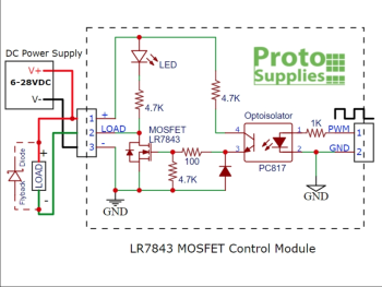

Znalazłem jeszcze takie coś. Zamówiłem bede testował. Pytałem osoby która to używa i mówi że działa wszystko ok. https://a.aliexpress.com/_EQ06uI0 Dla zainteresowanych schemat -

Wiem że taki układ popularny np na irf520 są ale przy dużym obciążeniu są problemy. Ok więc wywołuje kolegów. Może jakiś gotowy układ to z chęcia kupie. @_LM_ @jand @H1M4W4R1 Znalazłem coś takiego widzę że ma optoizolacje https://www.aliexpress.com/p/tesla-landing/index.html?scenario=c_ppc_item_bridge&productId=1005010311590236&_immersiveMode=true&withMainCard=true&src=google&aff_platform=true&isdl=y&src=google&albch=shopping&acnt=708-803-3821&isdl=y&slnk=&plac=&mtctp=&albbt=Google_7_shopping&aff_platform=google&aff_short_key=UneMJZVf&gclsrc=aw.ds&&albagn=888888&&ds_e_adid=&ds_e_matchtype=&ds_e_device=c&ds_e_network=x&ds_e_product_group_id=&ds_e_product_id=pl1005010311590236&ds_e_product_merchant_id=742682956&ds_e_product_country=PL&ds_e_product_language=pl&ds_e_product_channel=online&ds_e_product_store_id=&ds_url_v=2&albcp=19735245762&albag=&isSmbAutoCall=false&needSmbHouyi=false&gad_source=1&gad_campaignid=19735247190&gbraid=0AAAAAD6I-hEE6MeF8aA6dh7klwsCmdfMa&gclid=Cj0KCQiAnJHMBhDAARIsABr7b84AzSDN-IT56dOcjvkfyIhZzXktSpwLzy7TBIYBSoJS9e4MQlRrx04aAgHNEALw_wcB EDIT Narysowałem sobie schemat biorąc uwagi farmaceuta. Czy teraz jest ok? Czy wartośći rezytorów mogą takie być? -

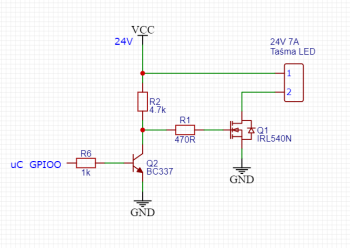

Witam Chciałbym sterować taśmą led sciemnianie/ rozjaśnianie. Taśma 24V 5-7A z poziomu ESP8266. Czy mosfet IRL540N będzie dobrym rozwiązaniem? Widzę że ma dobry Rdson. Bardzo mi zależy, żeby nie było efektu żarzenia taśmy po wyłączeniu i żeby nic się nie grzało. Może macie coś sprawdzonego mile schematy linki? Dodam jeszcze że używałem jakiś czas temu tego i po wyłączeniu taśmy był efekt żarzenia. https://allegro.pl/oferta/modul-pwm-mosfet-400w-15a-5v-36v-mos-arduino-raspberry-esp32-16481236160 -

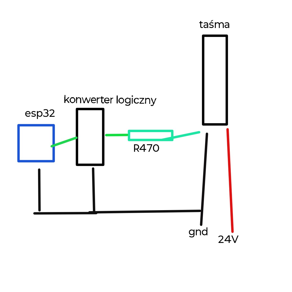

Witam Chciałbym podłączyć taśmę programowalną WS2812B 24V do ESP32. Zasilana na 24V z tego względu że mniejszy pobór prądu. Mama planach zrobić 10 pasków jedno metrowych, każdy osobno sterowany z procka. Jeden pasek będzie miał 1 metr x10 pasków sterowane osobno, co daje 600 diod. Z tego co znalazłem to nawet przy zasilaniu 24V sygnał sterujący wystawia 5V. Czyli rozumiem, że wystarczy dodać od taśmy rezystor 470R i dodatkowo konwerter logiczny z 5V na 3.3V Sory za schemat, ale nie mam kompa pod ręką i rysowałem na tel.

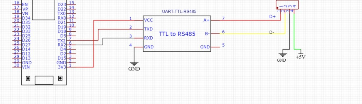

Jeśli chodzi o DE/RE to tych pinów nie muszę używać, ponieważ używam konwertera z automatyczną kontrola przepływu. Stosowałem go już z czujnikiem, który pracuje z modbus i działa ok. Jeśli chodzi o odbiór bajtów to 25 musi być odebrane. Dane są wysyłane co 16s z urządzenia po RS485 Zapomniałem o użyciu w Arduino readBytes narazie kod wrzuciłem na surowo, ale muszę poskładać wszystko w jedną całość. Serial.readBytes(buffer, length) -
Cześć Nie mam jeszcze fizycznie urządzenia. Chciałbym z niego odczytać dane za pomocą esp32. Urządzenie korzysta z protokołu RS485- UART. Nie jest to Modus. Rozumiem, że na początek muszę podłączyć konwerter. Czy tak to powinno wyglądać? Z urządzenia wychodzą 4 przewody D+,D-,gnd, VCC(4,5-6V) Dokumentacja https://docs.google.com/spreadsheets/d/1LGTdl4474DxEXoYOsrr-g2m9RTHT4h1s/edit?usp=sharing&ouid=109465326608173892426&rtpof=true&sd=true Odczyt 25 bajtów. Czy przykładowy program powinien tak wyglądać? Czy mógłby ktoś pomóc przy kodzie? #define RXD2 16 #define TXD2 17 const int BYTE_COUNT = 25; byte buffer[BYTE_COUNT]; int received = 0; void setup() { Serial.begin(115200); Serial2.begin(9600, SERIAL_8N1, RXD2, TXD2); Serial.println("Czekam na 25 bajtów..."); } void loop() { // Jeśli są dostępne dane w buforze while (Serial2.available() > 0 && received < BYTE_COUNT) { buffer[received] = Serial2.read(); // odczyt jednego bajtu received++; } // Gdy odebrano pełne 25 bajtów if (received == BYTE_COUNT) { Serial.println("Odebrano 25 bajtów:"); for (int i = 0; i < BYTE_COUNT; i++) { Serial.print(buffer[i], HEX); Serial.print(" "); } Serial.println(); // Reset licznika odbioru received = 0; } }
