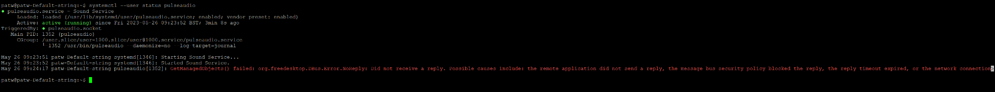

1 godzinę temu, ethanak napisał:
systemctl --user status pulseaudio
wyrzucio mi takie coś:
patw@patw-Default-string:~$ systemctl --user status pulseaudio
● pulseaudio.service - Sound Service
     Loaded: loaded (/usr/lib/systemd/user/pulseaudio.service; enabled; vendor preset: enabled)
     Active: active (running) since Fri 2023-05-26 09:23:52 BST; 3min 8s ago
TriggeredBy: ● pulseaudio.socket
   Main PID: 1352 (pulseaudio)
     CGroup: /user.slice/user-1000.slice/[email protected]/pulseaudio.service
             └─1352 /usr/bin/pulseaudio --daemonize=no --log-target=journal
May 26 09:23:51 patw-Default-string systemd[1346]: Starting Sound Service...
May 26 09:23:52 patw-Default-string systemd[1346]: Started Sound Service.
May 26 09:24:17 patw-Default-string pulseaudio[1352]: GetManagedObjects() failed: org.freedesktop.DBus.Error.NoReply: Did not receive a reply. Possible causes include: the remote application did not send a reply, the message bus security policy blocked the reply, the reply timeout expired, or the network connection
Czyli pulseaudio działa sobie w trybie user, teraz dalej. I nie wrzucaj mi słitaśnych foci swojego ekranu bo i tak nie dam rady ich obejrzeć.
