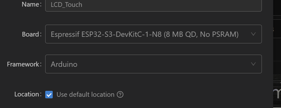

@_LM_ w platformio to jaka konkretnie płytka będzie, bo nie widzę esp32 s3 devboard.
Dwa, jak w platformio poustawiać te wszystkie rzeczy od pamięci co robiliśmy w IDE dzisiaj?

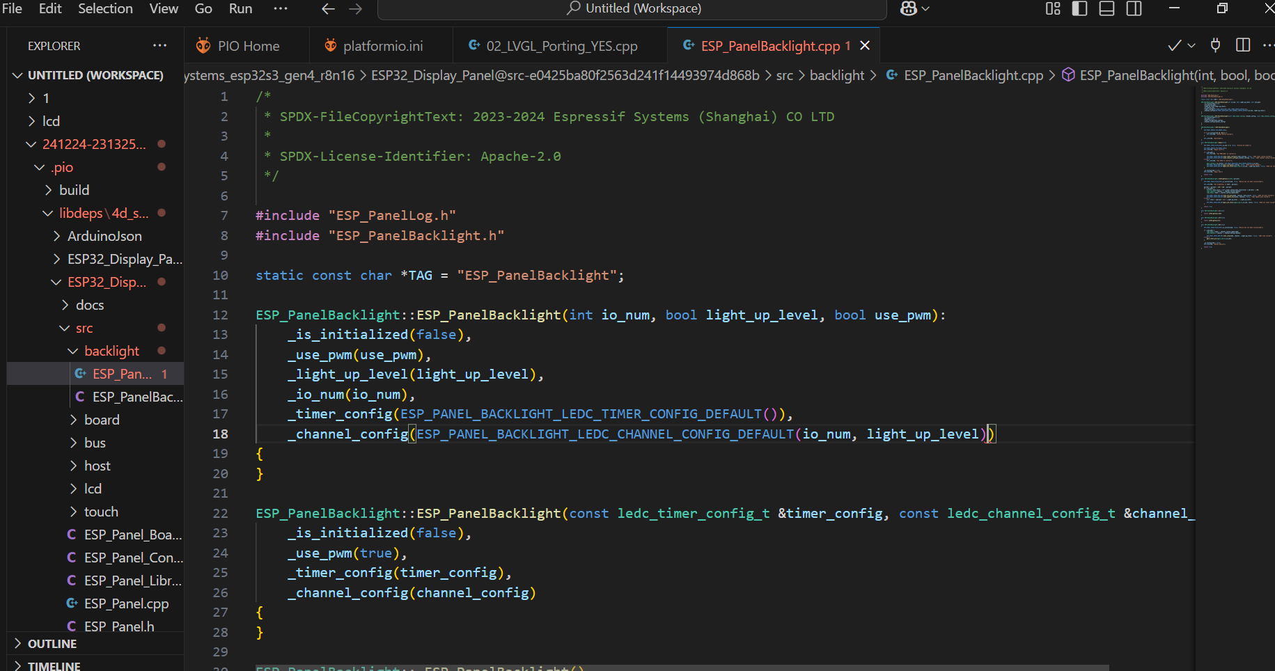

No i kompilator wywalił mi w końcu coś takiego:
Compiling .pio\build\4d_systems_esp32s3_gen4_r8n16\lib73f\ESP32_Display_Panel@src-e0425ba80f2563d241f14493974d868b\bus\I2C.cpp.o
.pio/libdeps/4d_systems_esp32s3_gen4_r8n16/ESP32_Display_Panel@src-e0425ba80f2563d241f14493974d868b/src/backlight/ESP_PanelBacklight.cpp: In constructor 'ESP_PanelBacklight::ESP_PanelBacklight(int, bool, bool)':
.pio/libdeps/4d_systems_esp32s3_gen4_r8n16/ESP32_Display_Panel@src-e0425ba80f2563d241f14493974d868b/src/backlight/ESP_PanelBacklight.cpp:18:92: error: no matching function for call to 'ledc_timer_config_t::ledc_timer_config_t(<brace-enclosed initializer list>)'
     _channel_config(ESP_PANEL_BACKLIGHT_LEDC_CHANNEL_CONFIG_DEFAULT(io_num, light_up_level))
In file included from .pio/libdeps/4d_systems_esp32s3_gen4_r8n16/ESP32_Display_Panel@src-e0425ba80f2563d241f14493974d868b/src/backlight/ESP_PanelBacklight.h:9,
                 from .pio/libdeps/4d_systems_esp32s3_gen4_r8n16/ESP32_Display_Panel@src-e0425ba80f2563d241f14493974d868b/src/backlight/ESP_PanelBacklight.cpp:8:
C:/Users/katon/.platformio/packages/framework-arduinoespressif32/tools/sdk/esp32s3/include/driver/include/driver/ledc.h:56:3: note: candidate: 'ledc_timer_config_t::ledc_timer_config_t()'
 } ledc_timer_config_t;
C:/Users/katon/.platformio/packages/framework-arduinoespressif32/tools/sdk/esp32s3/include/driver/include/driver/ledc.h:56:3: note:   candidate expects 0 arguments, 1 provided
C:/Users/katon/.platformio/packages/framework-arduinoespressif32/tools/sdk/esp32s3/include/driver/include/driver/ledc.h:56:3: note: candidate: 'constexpr ledc_timer_config_t::ledc_timer_config_t(const ledc_timer_config_t&)'
C:/Users/katon/.platformio/packages/framework-arduinoespressif32/tools/sdk/esp32s3/include/driver/include/driver/ledc.h:56:3: note:   no known conversion for argument 1 from '<brace-enclosed initializer list>' to 'const ledc_timer_config_t&'
C:/Users/katon/.platformio/packages/framework-arduinoespressif32/tools/sdk/esp32s3/include/driver/include/driver/ledc.h:56:3: note: candidate: 'constexpr ledc_timer_config_t::ledc_timer_config_t(ledc_timer_config_t&&)'
C:/Users/katon/.platformio/packages/framework-arduinoespressif32/tools/sdk/esp32s3/include/driver/include/driver/ledc.h:56:3: note:   no known conversion for argument 1 from '<brace-enclosed initializer list>' to 'ledc_timer_config_t&&'
*** [.pio\build\4d_systems_esp32s3_gen4_r8n16\lib73f\ESP32_Display_Panel@src-e0425ba80f2563d241f14493974d868b\backlight\ESP_PanelBacklight.cpp.o] Error 1
=============================================== [FAILED] Took 29.61 seconds ===============================================
 *  The terminal process "C:\Users\katon\.platformio\penv\Scripts\platformio.exe 'run'" terminated with exit code: 1.
 *  Terminal will be reused by tasks, press any key to close it.
3. Nie wiem o co mu chodzi bo to te same pliki z demo które bez problemu łyknęło IDE.

esp32-s3-devkitc-1
